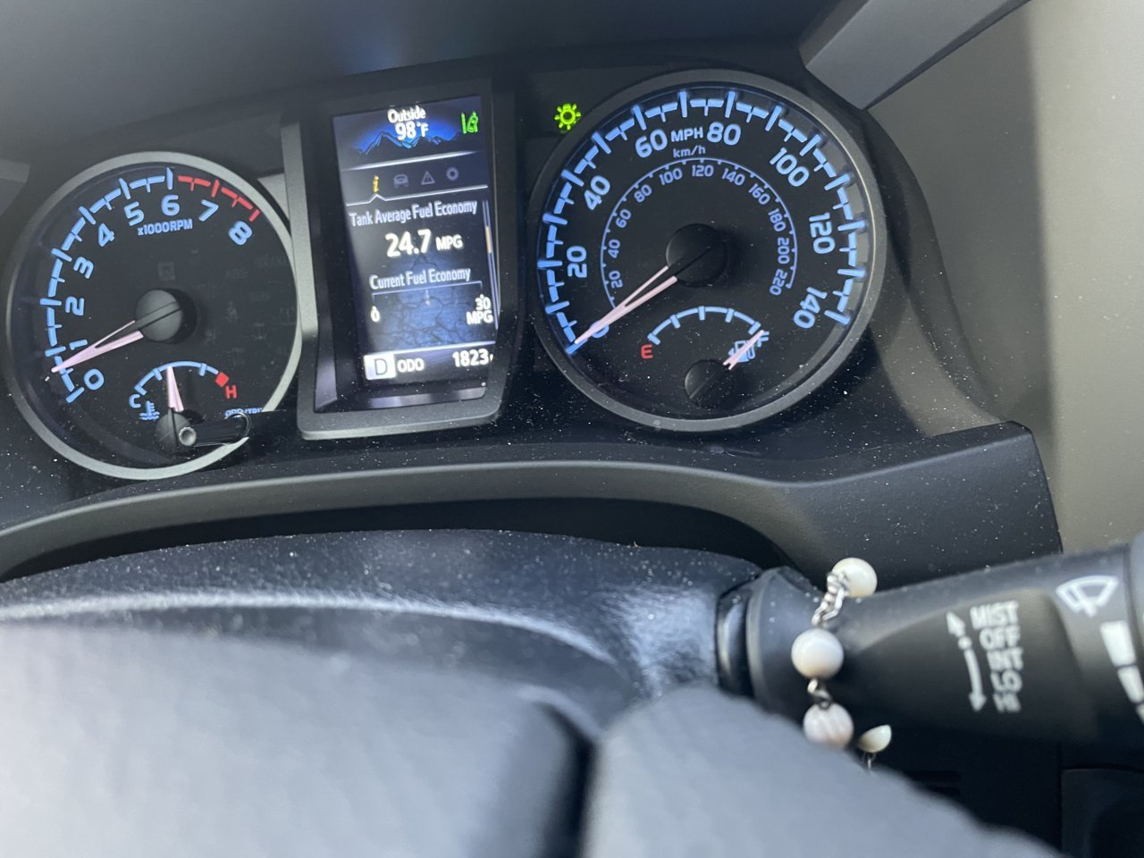

    Your tank shows full though, so the MPG on the display started over.

    wrong ........you just filled up

    Wrong it's always like this. Seems to be a lot of mileage envy on here. Learn to drive better and get better mileage. Or just trying to hype up the new engine by trying to put down current one :rofl: some of you all are childish. What's your mpg at? Good morning

    you dropped a pic at the top of your tank as if that's indicative of mpg over distance. i'm pretty sure you had some idea how that would go over.

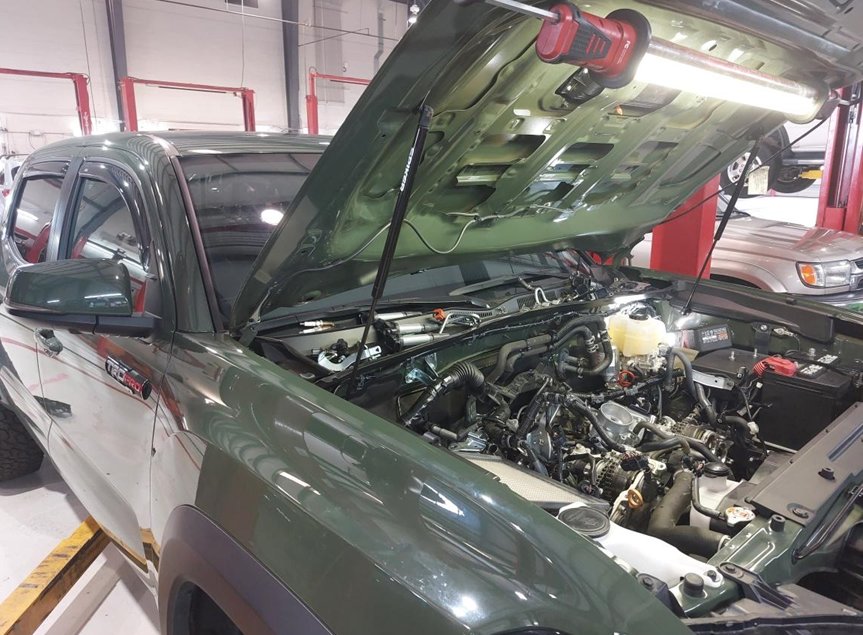

    I'm almost inclined to go along with your buddy.
    Ask me how I know? #6 cylinder failed compression/leak down test. 16K miles!

    The center cluster gauge is a bit misleading, I can get it up in the 30s if I fill up then hit the interstate driving 60. The informant screen History section is more true to what the average tank is, it will record what the best average is. Even though it says the current average is 24.9… the actual tank average will drop to 22.5-23. Still not bad.
    Let’s see your informant screen history. :)

    Bro how'd it go over? I'm getting great gas mileage. :rofl:

    no, genius.
    he means you literally just filled up and took that pic. it's not very indicative of the true MPG since it has had no time to do any averaging. on the flip side if you filled up and then just floored it out of the gas station until the speed limiter kicked in you're gonna see tank average mpg of like 7.

    nobody tell him we all have first hand experience with the Tacoma's mpg gauge, he seems to be having such a great time thinking no one noticed the full tank.
    or maybe he really doesn't know how it works himself.
