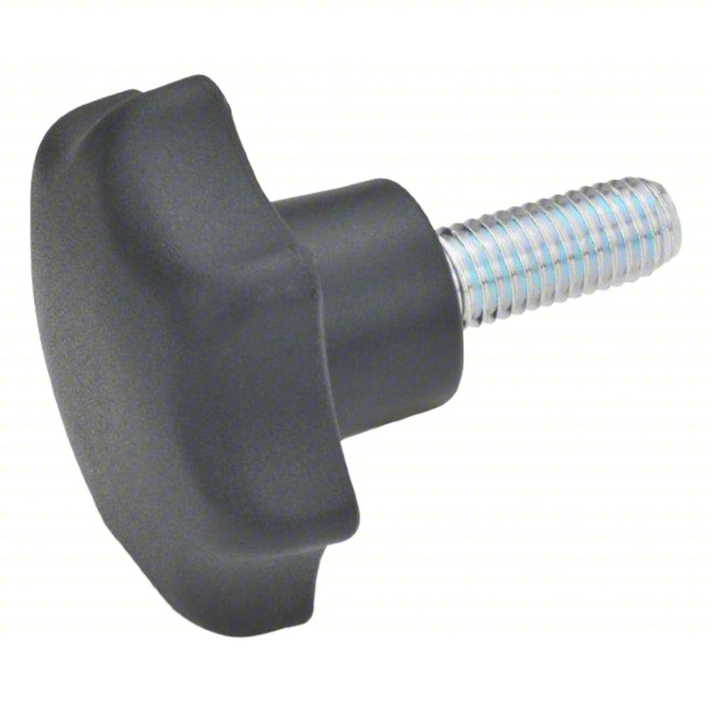

    Anyone else hate the screws they use for the skid plates, I damn near cross-threaded one. Next time I'll put some never seize on them, they looked like they had a little deformation that "helps" keep them from backing out?
  20. Sep 9, 2024 at 10:38 AM
    #200
    Xbowguy
    Xbowguy Well-Known Member
    Jul 30, 2022
    #402479
    285
    Jeff
    Pa
    2023 Tacoma 4x4 SR5 double Cab Barcelona Red
