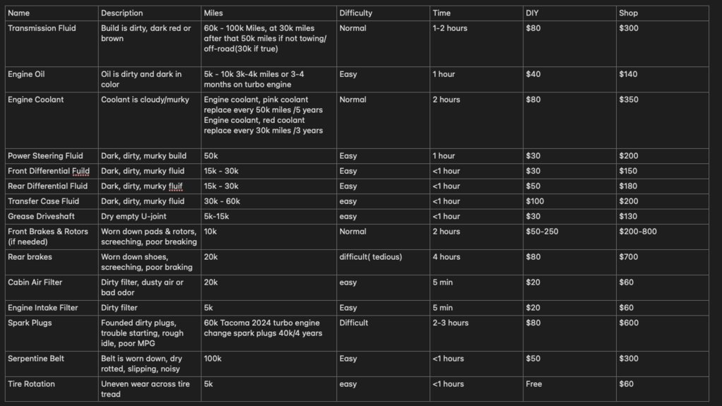

    I didnt find any maintance besides oil. I watched some youtube and created a chart. This is for normal driving, for offroad and towing the oil change should be 5k instead of 10k and i assume that applies for the rest of the things. Am i missing anything here? this is just a rough chart for now. Got this list for thecarcarenut guy from youtube:
    1. pcv valve (positive crank case ventilation valve) maybe after 100k miles ( turbo 40k-60k)
    - Change the plugs at 40k, then next 40k change the plugs and pcv valve
    2. Change WS Fluid every 60k miles (dont flush, just drain and refill). HYBRID 60k-90k. If hybrid has e-TRANSAXLE FLUID TE fluid clear color (not red), every 60k very thin fluid
    3. Inverter coolant pink 50k miles
    4. Hybrid battery fans, clean them, do not block them
    5. E-transaxle: TE fluid, every 60k miles

    I'm just scratching my head about your comment about a spark plug change being "difficult" with this truck. It looks to me like it's an easy 30-45-minute task—much easier than the previous generation. Maybe I need to take a second look.

    Ah, majority info i got is from youtube ;).

    There's no power steering fluid to change. It's electric.
    The spark plug interval, according to the maintenance schedule, is 40k. I don't know why it'd be difficult. There's just four, and they're accessible right from the top of the head after you disconnect and remove the coils.
    I'm not sure why rear brakes would be harder than the fronts. It's front and rear disc; there's no shoes or the associated springs, arms, and adjusters to contend with. I haven't done them on this truck yet, but most other cars I've done them on, the rears are easier. Everything is smaller and not so tight. I don't know how we're going to deal with the electric parking brake yet, but many cars nowadays have a motor that turns a jackscrew attached to the piston. You can use a scantool to back it off. Often, if you don't have a scantool like most of us home gamers, you can get away with popping the motor off, winding the jackscrew back by hand, then backing the piston off as you normally would. Last couple times I did it, it added about five minutes to the job. I also take issue to the interval. Unless you're driving like a complete toolshed or towing/hauling all the time, 10k or even 20k is way too short for a set to last. I'd inspect and lubricate them annually and expect to replace them every 30k or so.

    awesome, thank you. i just noticed that i dont have torgue listed...

    Some of these mileages are so fantastically short. Are you using reputable sources? 3k OCI and 10k brakes? For real? My 24/7 track day Tacoma?

    this is still rough draft, im adjusting as i go. Youtube is not really reputable sources :)

    My 3rd gen brakes went for 110,000. I don't expect to see anything different with this gen.

    I don't understand the point of the exercise. Why not use the Toyota maintenance schedule?? Or at least use that as a starting point and adjust it to YOUR preferences - like a more frequent oil change interval, etc.
    It seems like you are re-inventing the wheel using wildly unreliable sources.
