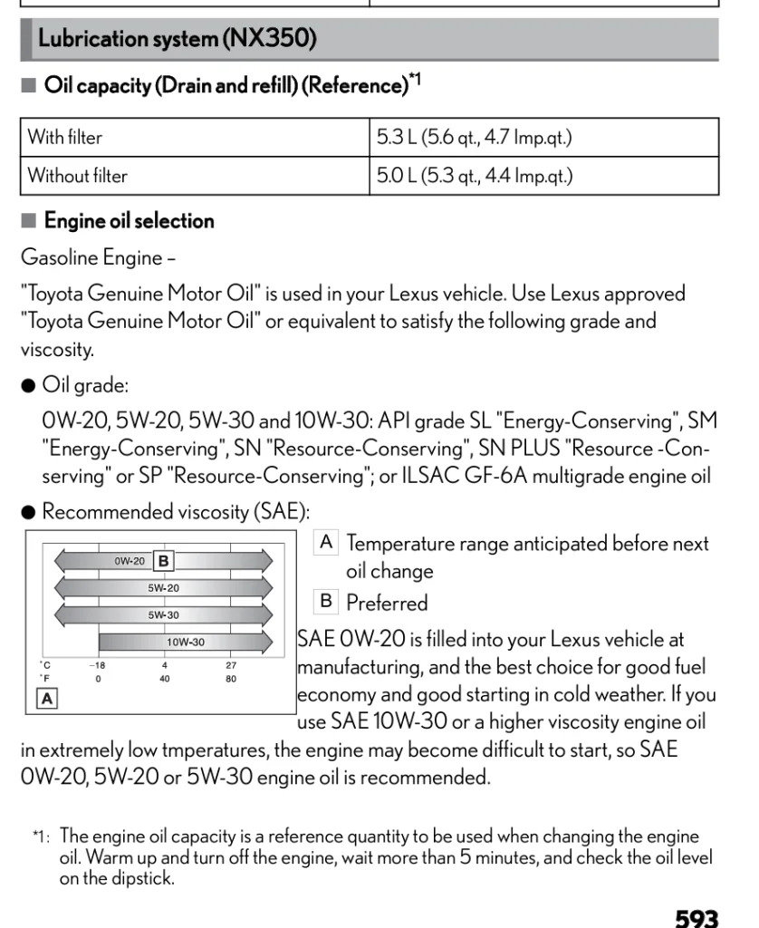

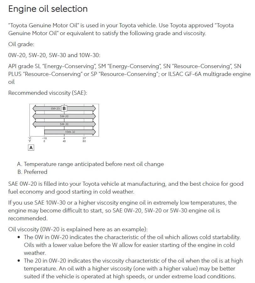

    This is copied by user SimpleSyrup on bobistheoilguy forums on why only 0w20 is listed in the U.S owners manual of the t24a-fts for the tacoma.
    The way I understand how the regulations work, the oil grade used for the fuel economy certification is the only grade of oil the manufacturer can list (in the USA).
    The 2024 Tacoma in the USA stipulates using 0W-20 GF-6A, API SP oil.
    But the identical engine used in other vehicles, sold elsewhere, tells a different story. 0W-20 to 10W-30, and API SL, SM, SN, SN+ or SP are fine. This is from the UK owner's manual for the Highlander, using the T24A-FTS engine:
    Lexus NX350 2022+, also using T24A-FTS engine. Australian owners manual:
  12. Feb 11, 2025 at 8:25 AM
    #332
    Light1984
    Light1984 Well-Known Member
    Nov 30, 2017
    #237337
    242
    24 TRD OR Hybrid Bronze Oxide
    Do the other manuals have a different part number for the oil filter or is it the same one regardless of oil weight?
  13. Feb 11, 2025 at 8:28 AM
    #333
    Johnny919
    Johnny919 Well-Known Member
    Nov 15, 2015
    #169739
    1,385
    John
    Long Island, NY
    2006 Honda Pilot EXL 4WD
    I am not 100% sure, I copied this over from the other forum. I have not been able to find the owners manual pdf for other countries.
    I would imagine the part numbers would be the same.
  14. Feb 11, 2025 at 8:36 AM
    #334
    Johnny919
    Nov 15, 2015
    #169739
    1,385
    John
    Long Island, NY
    Light1984 likes this.
