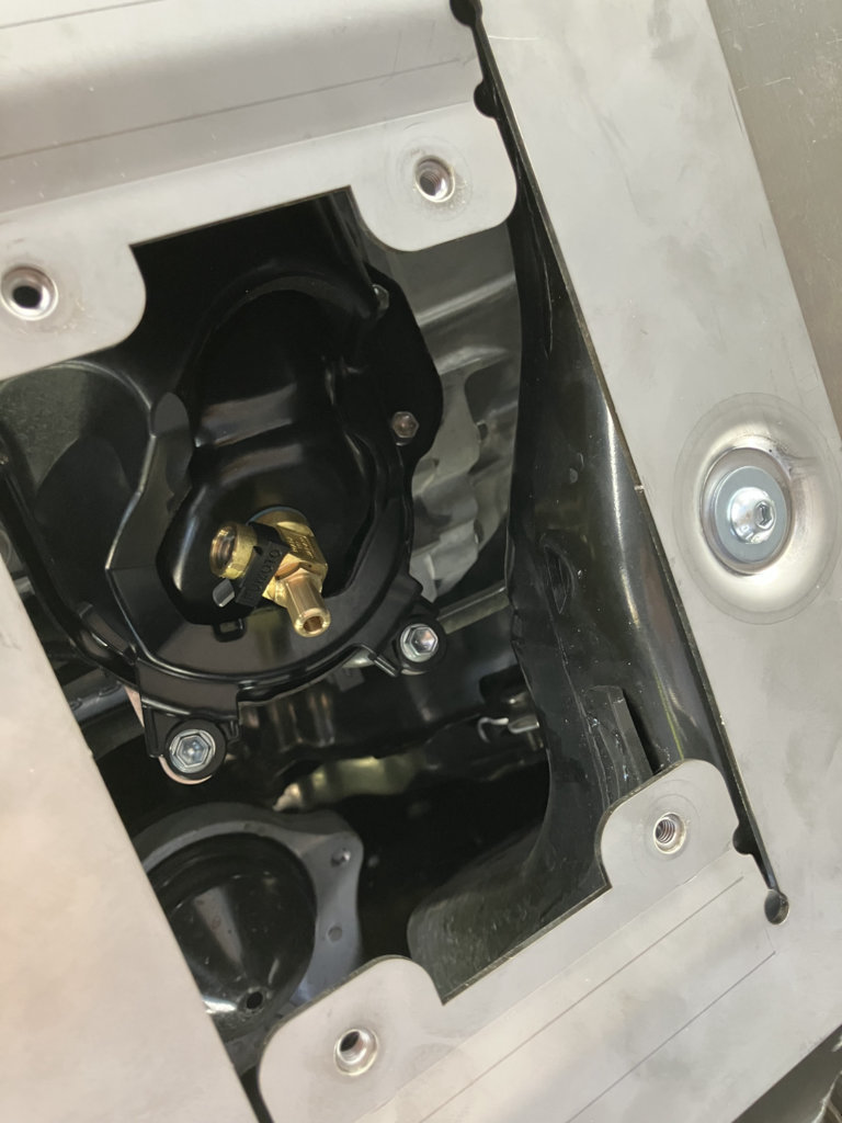

  17. Feb 25, 2025 at 3:33 PM
    #357
    nurp42
    nurp42 Well-Known Member
    Nov 23, 2024
    #461128
    167
    SoCal
    '24 PreRunner
    When I did oil change, added the Fumoto valve to reduce (hopefully eliminate altogether) future mess. This is my 1st Tacoma, but many experienced people here have recommended them. Pic below:
    Newwt, Dayen, DavesTaco68 and 3 others like this.
  18. Feb 26, 2025 at 7:05 AM
    #358
    Toyturckman
    Toyturckman Well-Known Member
    Sep 21, 2024
    #457442
    51
    Dave
    2024 Tacoma Hybrid Limited Underground
    None
    That is a nice touch OP I might do that at next change. Thanks.
  19. Feb 26, 2025 at 7:27 AM
    #359
    Toyturckman
    Sep 21, 2024
    #457442
    51
    Dave
    None
    Hey OP that was the long nipple or short nipple?
  20. Feb 26, 2025 at 9:29 AM
    #360
    SchwarzeEwigkt
    SchwarzeEwigkt Well-Known Member
    Sep 10, 2024
    #456823
    429
    Central NY
    ‘24 Tacoma TRD Sport 4x4, Solar Octane
    It's definitely a long-nipple version.
    What I want to know is what's the difference between the F103N and the F133N. They look identical. The spec sheets only differ in that the F103N lists the nipple length and diameter as "n/a" where the F133N lists dimensions. They seem otherwise identical except for the price; the FN103N inexplicably is on sale at the Fumoto site.
    Edit: Ah, the F103N is the old valve. The F133N has a larger internal orifice for faster oil flow. Seems like you probably want the F133N.
