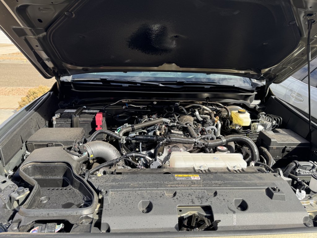

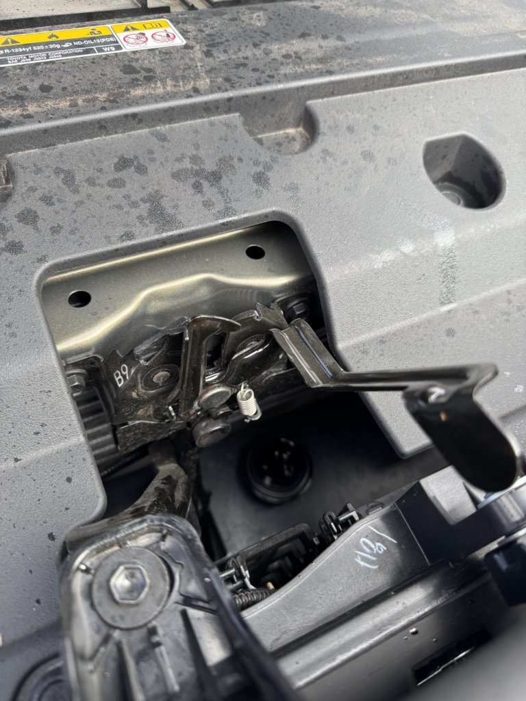

    Well, after reading all the opinions on when to get the first oil change on my 2025 OR Premium, my local Toyota dealership was having an oil change special for $49.95 so I thought “Why not?”. It has 925 miles on it.
    I took it down this morning and waited for 1.5 hours. On my way home, I smelled a little bit of an oil burning smell but attributed it to someone in traffic ahead of me because it seemed to subside a little later. I stopped at a light right by my house and saw some blue smoke wafting from the right front fender. I stopped in my driveway, left the engine on, and opened the hood. They had left to oil fill cap off and oil was spurting all over.
    I tried to check the oil level but since the oil is so new, I really couldn’t establish how much was in there. It was dripping oil so I know there is some. The level is probably not hardly low at all since I’m not far from the dealership.
    My wife found the cap in the space under the hood release mechanism.
    The dealership is sending a tech over to make sure the oil level is good then take it back for a good cleaning.
    Brand new truck. My baby. Sheesh!

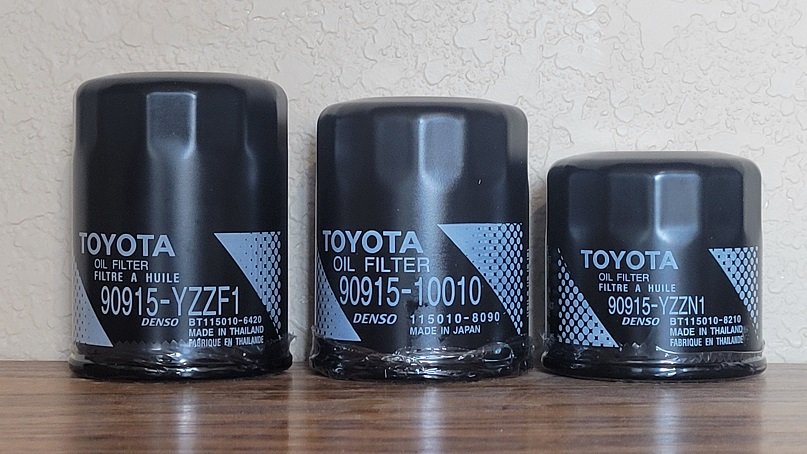

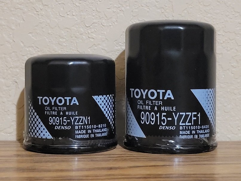

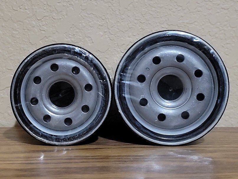

    I've been holding off on this until I get my truck and confirm my suspicions. I come from the mini-truck world (22R, 22RE, 3RZ). A world where Toyota wants us to use the D1 (G2) filter, but many of us run the larger Land Cruiser (V8) D3 filter. I suspected there was a larger option to the thimble-sized N1 filter Toyota wants us to run on our T24A engines. I have a write up ready to go once I get my truck in the garage and pull off the N1.
    There are two other options that have the same base, and are larger. 90915-YZZF1, and 90915-10010. The F1 and N1 are Denso Thailand. The -10010 is Denso Japan. The F1 is a car filter. The -10010 is the filter used on the 3.4L twin turbo in the new Tundra and Sequoia. The N1 and the F1 are the same price (~$6). The -10010 is about $3 more (~$9), I think I know why, but that will need to wait. My only concern is the F1 might be too tall for the space. A picture is worth a thousand words.

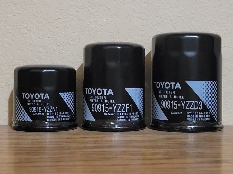

    For chuckles, N1, vs F1, vs D3. I would run the D3, but the base/gasket is larger diameter.

    I am still wondering why the standard filter is so tiny. The 10010 looks like a solid replacement

    Agree, that will be my choice too. I talked with the lead tech at my local dealer last week. He told me that Toyota is encouraging dealers to install the N1 on everything. He was concerned that Toyota will disco the F1 and the -10010, and encouraged me to stock up. Toyota does have a history of discontinuing Denso Japan oil filters in the USA (-20004, YZZB5, YZZB9 come to mind). Note that the three disco'd oil filters were resin element, not pleated paper. I have a suspicion that the -10010 might also be a resin element filter.

    I presume the implication here is that you want a larger filter for more capacity to hold contaminants and to increase oil capacity a bit. Thing is, just because a filter screws on doesn't mean it's appropriate for the application. Different filters have different characteristics. The one thing that leaps out to me is that they have internal bypass valves that open at a particular pressure. Just slapping another filter on without confirming it's right for the application can cause problems.
    Do we know that all these filters besides the -N1 have a bypass valve that opens at the appropriate pressure for the T24A-FTS? The fact that the one tech mentioned that Toyota seems to be moving toward using the -N1 for everything implies they probably do, but this probably should be confirmed before anybody starts trying to use an alternate filter.

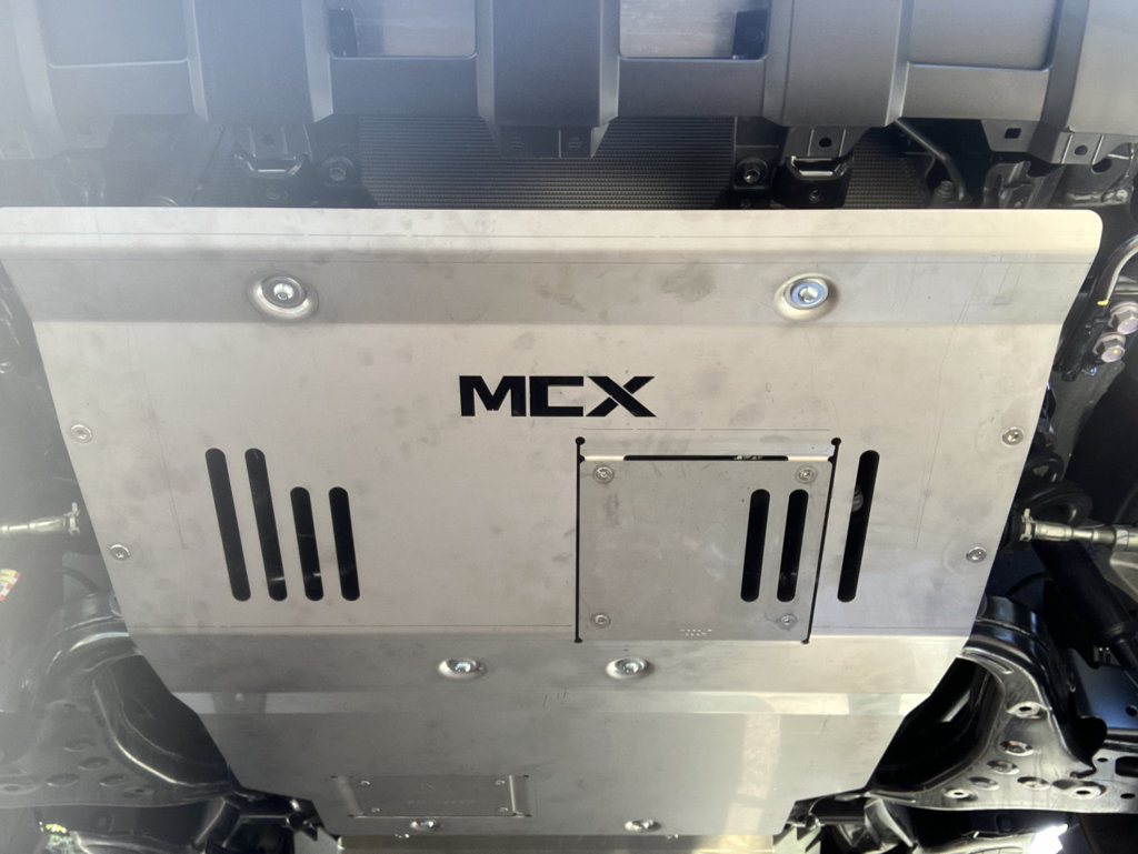

    Is that a Miller Cat (MCX) skid plate you're sporting in that pic?
  20. Mar 14, 2025 at 12:05 AM
    #380
    nurp42
    nurp42 Well-Known Member
    Nov 23, 2024
    #461128
    167
    SoCal
    '24 PreRunner

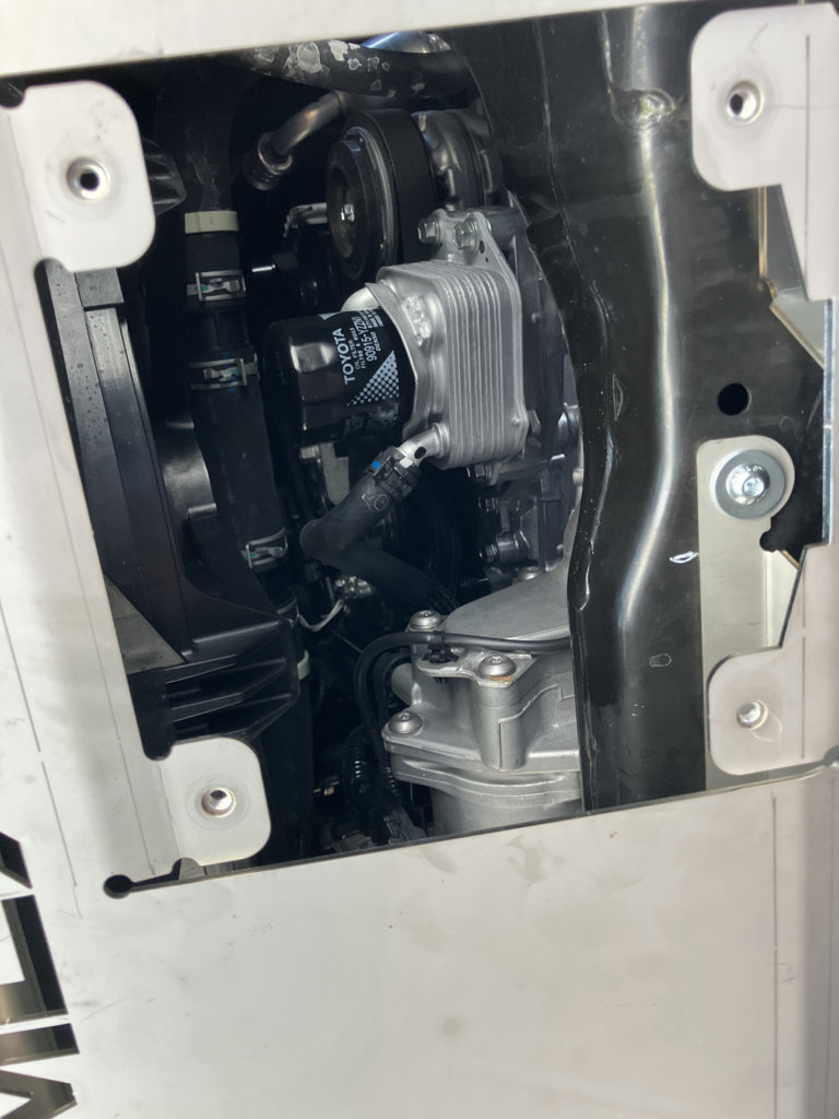

    Yes. It's an excellent item---- that pic w/ the Fumoto valve shows how good the access is to the drain plug and below is one showing the easy access to the filter as well (and the plate when everything is closed up too):
