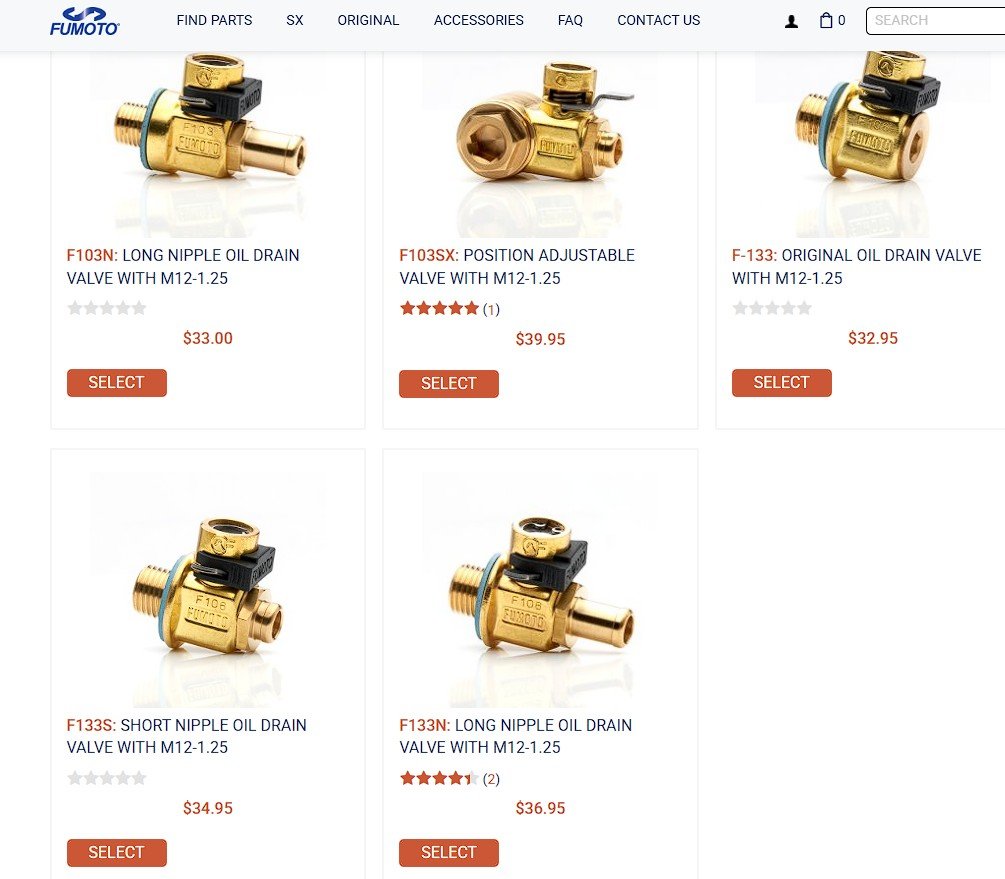

    BTW folks. Many have asked which Fumoto valve works for the 4th Gen Tacos. Here you go, your favorite flavors straight from Fumoto's web page for the 4th Gen:
    https://www.fumotousa.com/cars-pickups-toyota-2024-tacoma-2-4l-l4
    I went for the long nipple so I could snake a drain hose straight down to the drain pan for a no muss, no fuss oil drain. Some folks even leave the hose connected and tucked on top of their skid plate for even easier drains.

    FYI, it seems we probably want the F133 over the F103. I did some poking around and discovered that they're externally identical but the 133 has been reworked internally for more flow, which should allow for faster draining come time to do a change. The 133 now supersedes the 103. Sounds like it's worth the extra couple bucks to me.
    Newwt and GrrrMaker[QUOTED] like this.

    I have the original and I have no issues with “slow” drain. Just fyi. Not sure how much faster the flow will be…anyone have both to compare???
