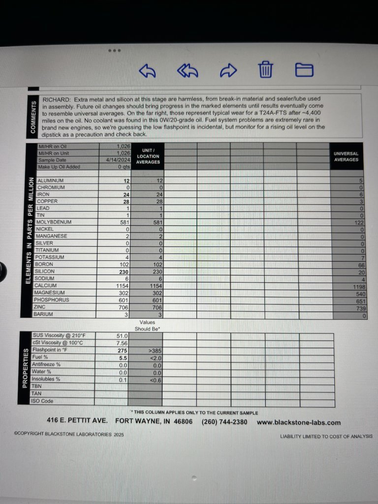

    (Does anyone know if the zinc reading of 706 means they are using breakin oil
    which is a break an additive ) ?

    Not Enough
    The zinc is about what it should be the moly is elevated a bit most likely from the factory oil
