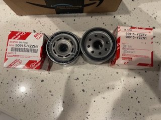

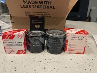

    Just did an oil change and add a fumoto oil drain doohiki, as you can see, I did some research on filters and such, got 2 set of 10qt oil from costco $30 per 10qt, 10 oil filters from Amazon for, $36, fumoto drain valve for quick nonmessy oil change for 45 on amazon. Just did my 1003 mile break in oil change and did the switch drain plug to fumoto today. For thos 5'7 or shorter, you may need something to stand on while you filing your oil lol Planning to do oil change every 4-5k miles from now on. Hardest part is that protective shield that you have to take off, putting it back is hardest part, didn't have to lift the truck, I even got underneath with a creeper and still be able to do whole process.
    IMG_3261.jpgfilter on left is oem, on the right is earlier version also has the part number of the oem current filter, original slightly taller just round holes instead of the slanted elongated hole of the new one.

    ( That bigger filter looks like it has smaller holes the the OEM,s oval ones. You might want calculate the open area of each filter and make sure that bigger one is at least the same or more than the OEM. If it’s less I would question using it )
