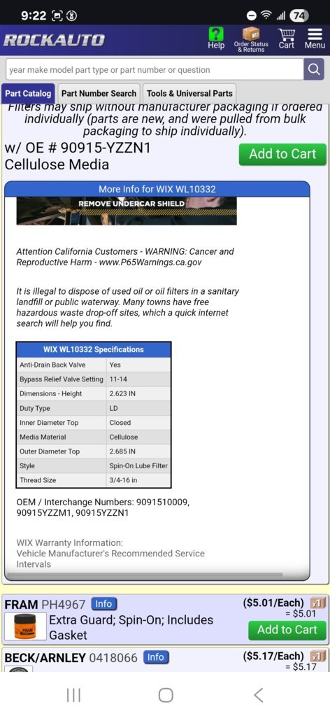

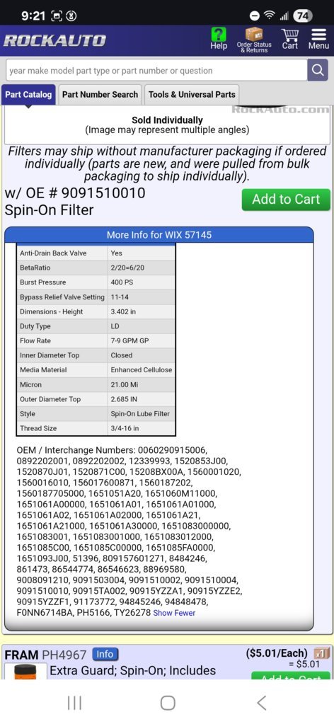

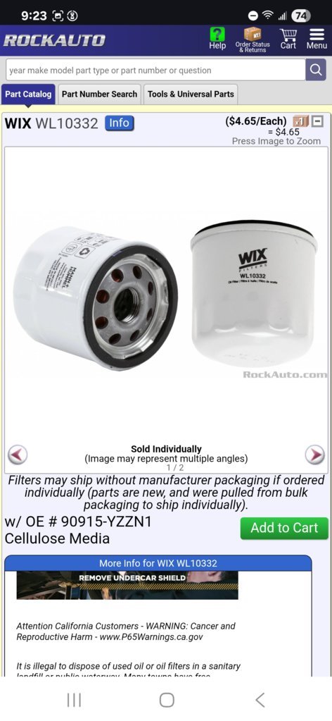

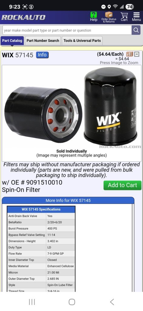

    I ordered a couple of the Wix filters you mentioned at the top of the post. The quality was terrible. Paint was already flaking off them. Who knows what already got into the media. Returned them. Interesting because I usually like Wix products.

    I think the question with bigger filters has always been how well the bypass valve performs with the Tacoma engine. I don't know the answer to that. I have heard that the N1 filter, though small, is a quality filter. Most will change at 5000 miles anyway, so a larger filter is probably a non issue

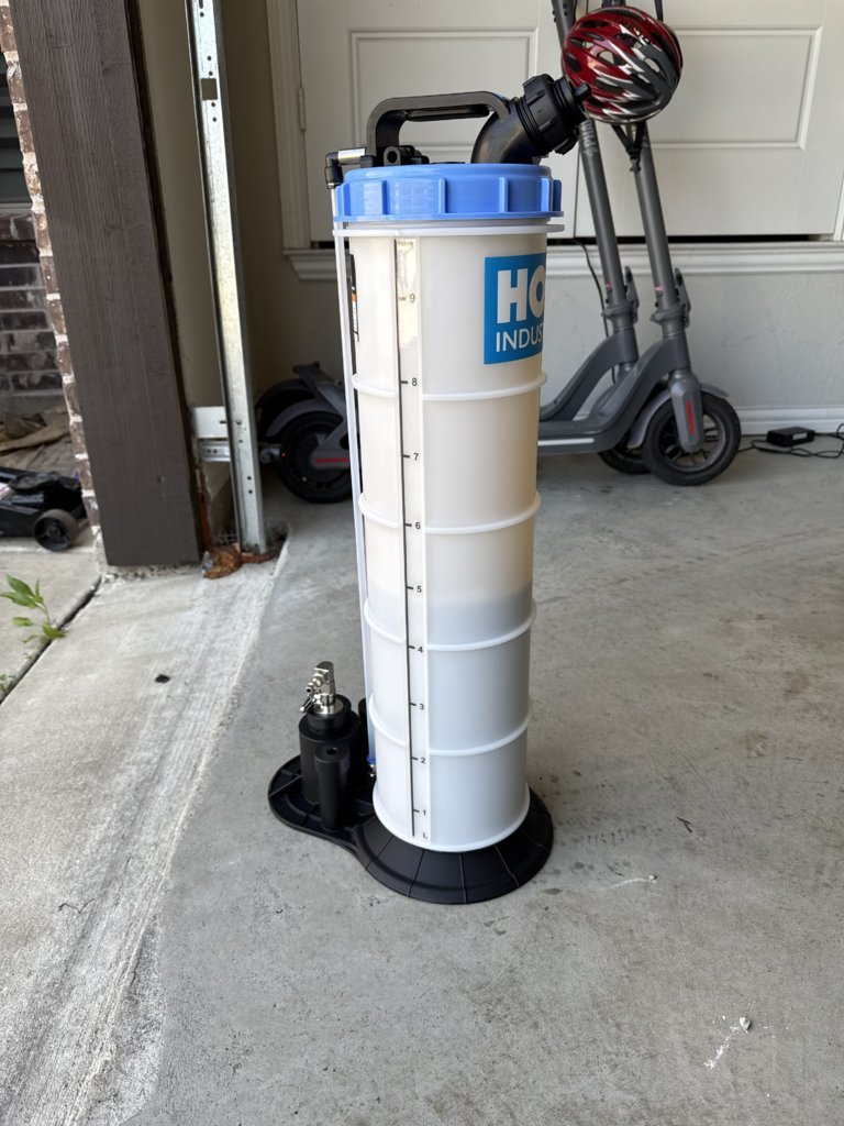

    Broke down and bought me one.....WOW....it worked great on my wrangler.
