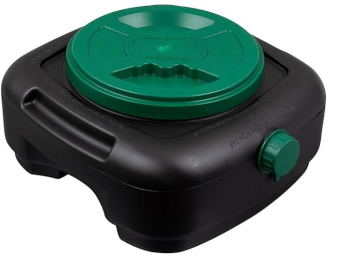

    I use this style, works well and avoids what happened to you. With the lid off there’s a big grid to catch the drain bolt if you drop it. Also good for finishing draining the filter.
    https://www.amazon.com/dp/B0D54RZCQ9

    Thanks! I think I had one like that way back in the day. Your "aim" has to be a little better with that than the rectangular one I have, but it should prevent the oil from reflecting back out from the flat surface. So odd, I've never had this happen in 45 years of doing oil changes :)
    I suppose you could put that container up on a box or something to get it closer to the drain to make it less likely it would overshoot that hole. Or even hold it up yourself until the big "sploosh" of oil is done.

    I just use a 2 gallon bucket and hold it right under the drain plug. I heard how watery the old oil is, so I came prepared. It does shoot out!

    yes, with a side exit oil drain so you have to pay closer attention. But as you say, you can hold it up to catch the initial bit and lower it once the flow moderates.
    that said, a Fumoto drain is really nice. I have one on my funcar. Downside is I don’t trust someone else to use it correctly and put the clip back. Think about that if you go that route, you’ll probably want to DIY future changes

    A Fumoto valve with its tube fixes that issue.
