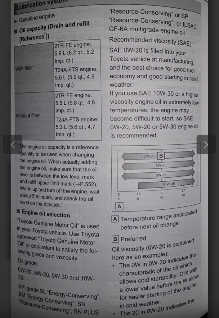

    Definitely true in Mexico as I posted earlier.
    Also, the LC Prado t24 calls for anything up to 10w30 in non-US markets. Here’s Saudi spec from the LC forums:

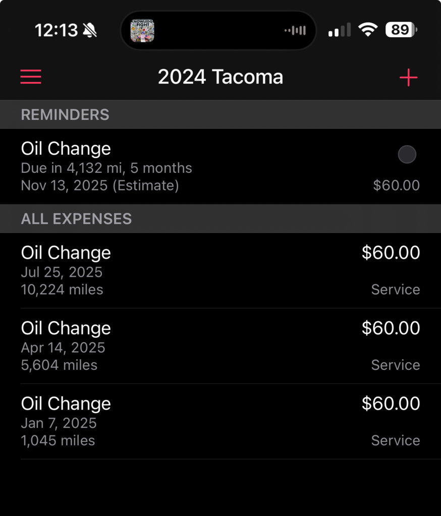

    You simply show them your records. The Walmart receipt doesn’t prove that the oil you bought went into the truck, so this line of logic means that they could refuse a warranty even with receipts. They show nothing more than a handwritten maintenance record does.

    Anyone can make up a maintenance log like that with no receipts to back it up - that proves nothing.
    I don't think most people are in the habit of buying 6 quarts of oil and an oil filter for a Toyota every six months just to stash it in their garage without using it. Having receipts for the required amount and type of oil along with a filter at reasonable time intervals should be sufficient.
    Not gonna argue this anymore. You keep the records you want to keep and I'll keep mine. Hopefully neither one of us needs to make a warranty claim anyway.

    It should be sufficient, just as a maintenance log and an engine that isn’t obviously running 30k miles on sludgy OEM oil is sufficient. Nobody keeps oil receipts for 8 years for their extended warranty because nobody needs to
