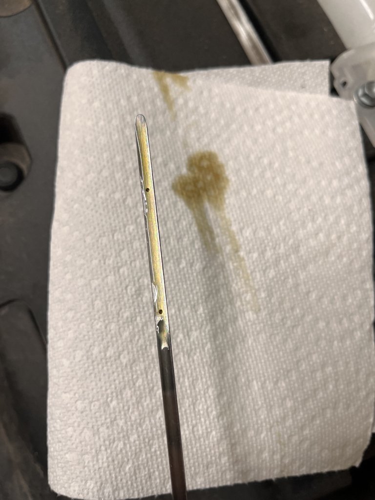

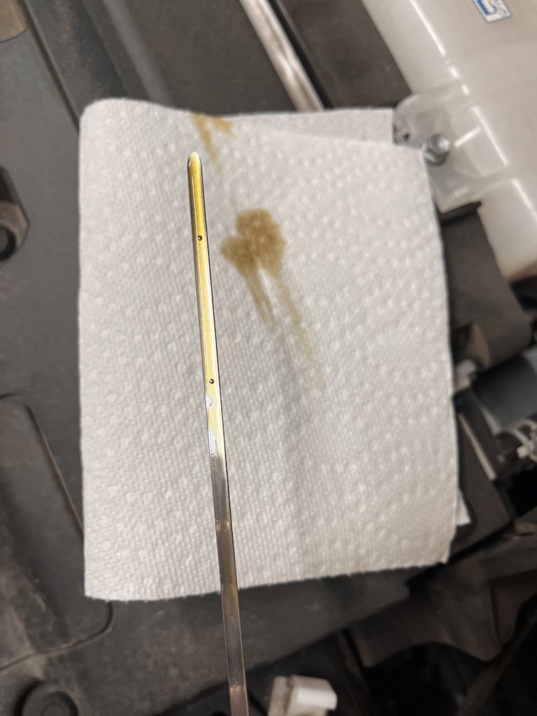

    Dumb question but anyone else have a hard time reading the dipstick? I got my oil changed at dealership and checked about 500 miles later. To me it seems overfilled but even when I change my oil I have a hard time reading the level. Especially with new oil. It always seems like it is overfilled even when I make sure to add only the capacity.
    I’m expecting to clearly see the level between the two dots.
    The gauges in the car show oil level as fine and I’m assuming the dealership knows how to add oil correctly.
    Bottom line is there a trick to reading the dipstick?

    T24A-FTS takes 5.9 qt with the filter, I bet most of the time they do 6, I wouldn't worry about it.
    My dipstick looks the same coming back from the dealer at the 1000 mile change and 5000 mile change. It takes way more oil than that to get issues with the crank frothing up oil in the pan.
    By the time you need an oil change again the part that's over the full line will be blown by through the rings :rofl:

    They're all hard to read with clean oil. Plus some oil always slops against the dipstick when it's pulled out. What I've found that helps is don't tilt the dipstick more than 90 degrees so the oil doesn't run up the dipstick, check both sides of the dipstick because I've found the backside has a clearer oil edge to see and do this as quickly as possible before the oil spreads around. Also if you look closely you'll see the area where the oil completely covers the width of the dipstick and an area where the oil is maybe half the width and tapering off. Where the oil completely covers the width is the oil quantity area. I wipe the dipstick and repeat a few times to be sure.
