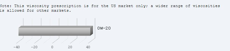

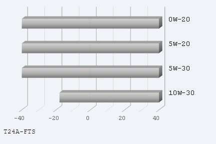

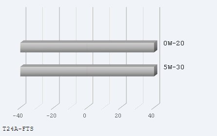

    Its just Toyota following government regulations so they don't get fined.
    US
    EU/JP
    AU

    People also should look at the fine print in the 2024 manual:
    Oil grade:ILSAC GF-6A multigrade engine oil
    Recommended viscosity: SAE 0W-20
    It's RECOMMENDED 0w-20.
    Further down the page:
    SAE 0W-20 is the best choice for good fuel economy and good starting in cold weather
    Doesn't sound like a mandate. It sounds like it's a recommendation. It's the "best choice" if your target is good fuel economy and cold weather. Maybe I don't live somewhere cold? Maybe I don't care about .05mpg extra on my truck because it's 96F and I have a 2500 mile trip ahead. So what should someone use? Well, the mandate is to find an ILSAC GF-6A oil.
    So what meets ILSAC GF-6A? The oil needs the API starburst on the front "For Gasoline Engines." There's a short list of oil grades too. Here's a reference: GF-6 FAQs | Team Valvoline (valvolineglobal.com) Item 7.
    ILSAC GF-6A can be used to meet GF-5 oil recommendations and earlier. GF-6A products will display the “Starburst” API mark. GF-6A is backwards compatible, meaning it encompasses GF1-5 standards as well and is designed for SAE grades 0W-20, 5W-20, 5W-30, and 10W-30.
    In other words, 5W-30 or 10W-30 would be just fine in the 2024 Tacomas. It's not the "recommended oil" but it absolutely meets the standard directly from the owners manual. This matches exactly the graphs above. Every oil on that list is in the ILSAC GF-6A viscosity range. Not a coincidence.
