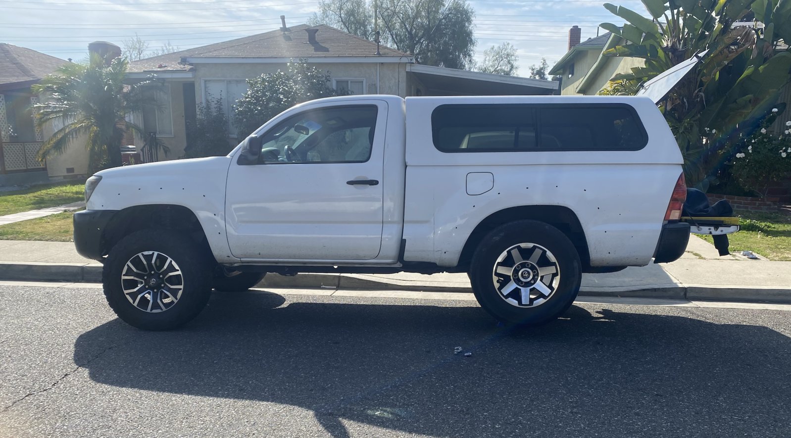

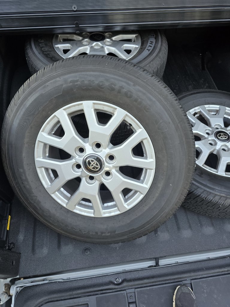

    So, I have a 2008 prerunner that I just bought my son and picked up these wheels yesterday for $300 with less than 500 miles on the tires. From what I am understanding is either I can not use these at all or I will need a spacer of some width that also converts to a 14 mm lug nut. Also, I cannot use the factory lug nuts for the mounting of the spacer, correct? Thanks in advance as I am new to the Tacoma world.

    Eh, I'd just swap the tires and sell the wheels - not worth looking for something that may not even exist and even if it does may not work to clear the brake caliper. Not a big market for adapting these wheels for said reason.
