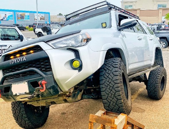

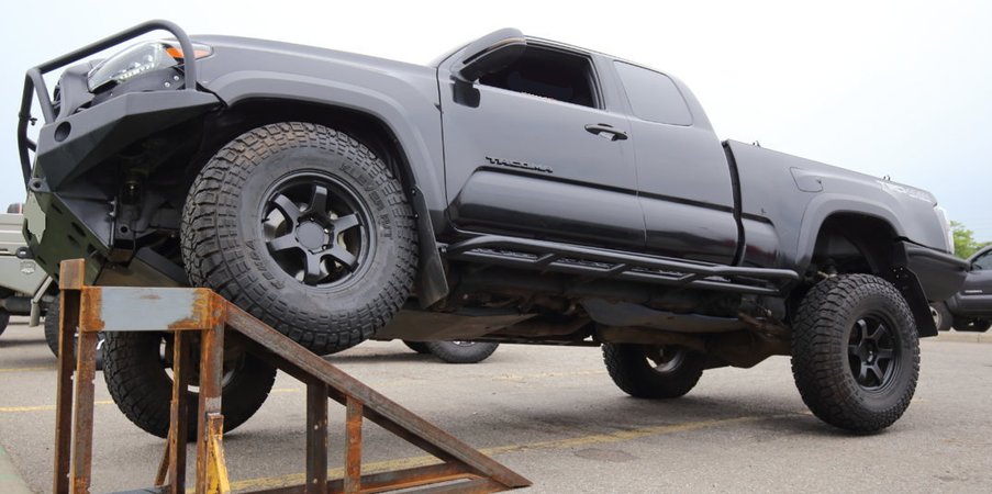

    If the 4Runner is any indication, stock vs. stock the 3rd gen Tacoma will outflex the 4th gen. A quick look at the short brake hoses should give you an idea of the restricted axle articulation:
    However, once modified it'll be a wash. And modified is what matters, because who wheels with stock suspension?
    We had a flex ramp at a local Toyota club meet / mall crawl. Notice the 4Runner got up to the same height on the flex ramp as my Tacoma, despite having a much shorter wheelbase. 4-link can flex very well if the surrounding components (shocks, bushings) can accommodate it:
