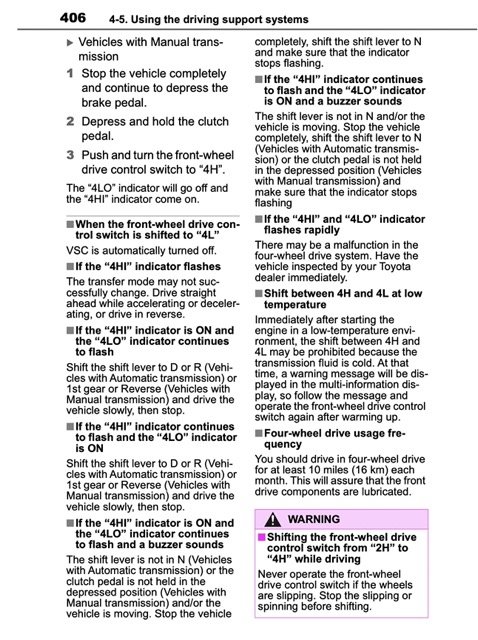

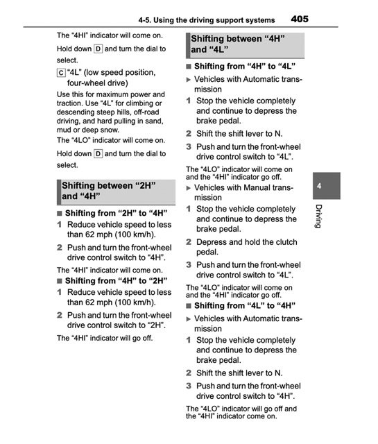

    Here's the owners manual stating the sequences...
    dleithaus, DRAWN and Turd Ferguson like this.
