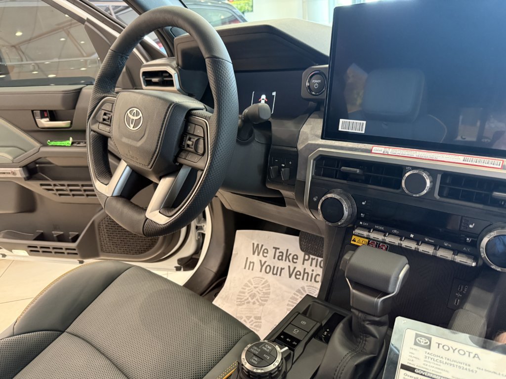

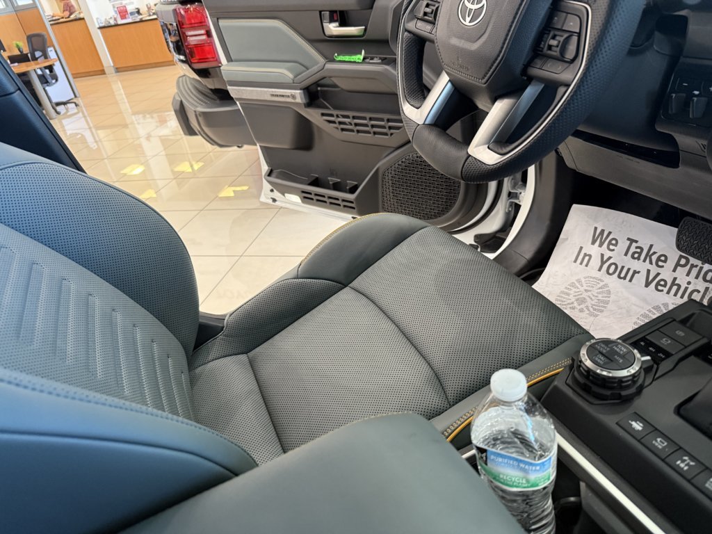

    What is everyone doing to upgrade the audio in 4th gen Tacoma's, since the radio is fixed to the dash? I'm considering this Trailhunter, but the factory audio doesn't cut it for me.
    JL Audio Fix 86?
    What about subwoofer options and mounting locations? The hybrid Tacoma battery takes up much of the back seat space.
    What about factory JBL vs non JBL upgrade options in the 4th gens?
    I kept the factory radio in my 3rd gen, but added a JL Stealthbox, Focal speakers and Kicker key 200.4/500.1 amps.
