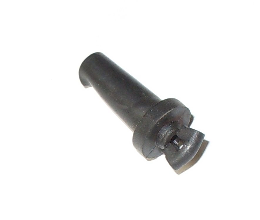

    Also, does anyone recognize this part? It was on the floor right under the bell housing after I finished the install. I swept the floor before pulling the Taco in.

    That part.....looks like a thingy

    Yes, a thingy. not from the A/C evap drain

    That's the breather from the starter. Or one of the previous 3. Not a major deal.

    I thought the same thing about the breather for the starter. I forgot to mention both the new and replaced starters had breathers after I found this part. I had just changed the oil on the car that is normally parked there. Maybe I knocked something off that car but didn't sweep it up.

    :oldglory:That part was your dip stick holder,
