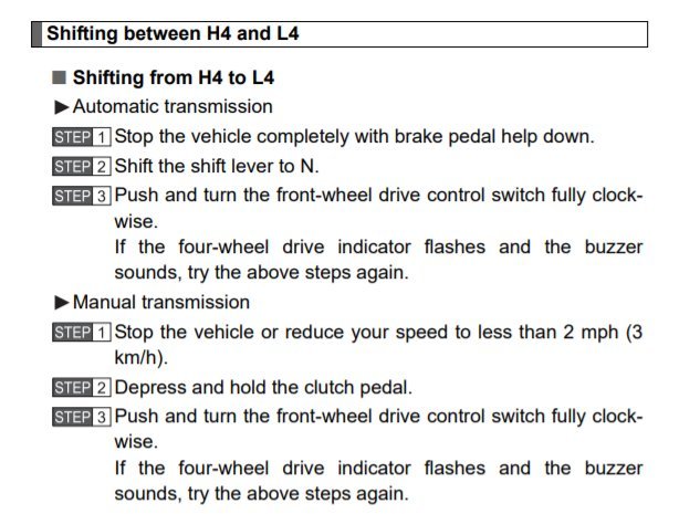

    Ok, since there is way too much confusion going on here, this is pulled straight from a 2015 owners manual.

    I own an MT but the manual say AT needs Neutral as well

    So, of course The sticker on drivers sun visor says same as owners manual , Thanks you I just tried 4w system again, multiple times, it does go into H4 and drives fine no buzzer,, but it is obviously not going into L4 range, I get to step 3 in owners man. and it says try above steps again it keeps and beeping flashes and starts Dinging and telling me something is Wrong, I retried step 3 multiple times and it wont go into low range, When i am Driving it 15 mph in both L&H ranges its the same ~1500 RPMs, 4H is fine, no alarms i had tried it b4 2 weeks ago per instructions on visor to no avail, I am completely new to electric tcases, but have used manual ones for a Few yrs now, Almost 300K miles on my 1990 I have owned for 29 yrs (I know its not A TACOMA) and it never fails to shift into all gears and ranges, still going strong, but my 2015 it is not going into low range ,,, so back to dealer for warranty work, thanks for page from the manual..

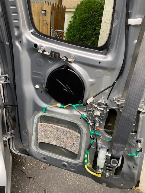

    Random ? would you happen to know if there are speaker wires in rear doors of 2015 TRD offroad access cab long bed, there are no speakers and the door panel is not louvered for speaker sound , i see multiple wires (3-5 hard to tell) going into my rear doors, i would assume 2 would be unused spkr wires hopefully i have seen other access cabs with speakers in rear doors. Maybe the offroad ver does not have the rear spkrs. Also the balance Rear fader fades to nothing to rear!! but they adverise it has 6 speakers, i count 4 up front..
    I was going to just lay or mount 2 small speakers in Boxs/Cabinets in access cab area and run wires to them from the doors. I guess i can ask in another post, not sure how to do a thorough search in TC for info on this subject??

    I suspect that the wires you see are for the power window and door locks..
    Im sure if you made a new thread in the 2nd gen section, someone would know for sure :thumbsup:
    yep,, only door closed switch wire and seat belt tensioner wires, NO speaker wires, speaker hole cover pops right off, but will have to run wires , i am just upgrading my cheap factory paper 6x9's with quality speakers for now, the factory speakers dont sound too bad but need upgraded for sure tks for reply
