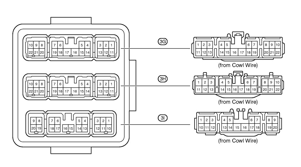

    I’m getting constant power at the 4wd fuse. The fuse is before power is sent to the computer I assume? In which case the disconnect is between the fuse and ecu or at the ecu. Correct me if this is the wrong line of thinking

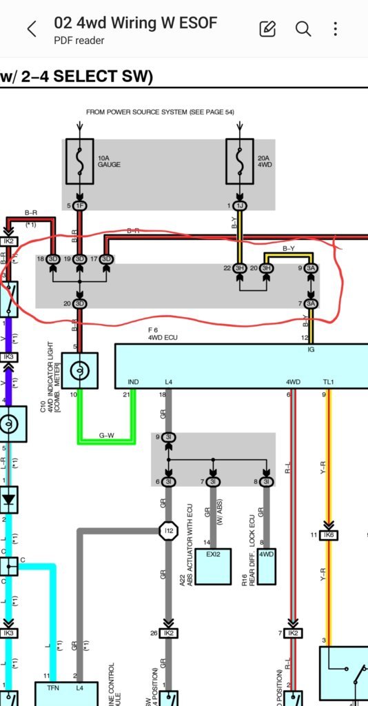

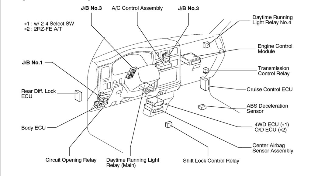

    IMG_3027.pngI’m assuming this is the junction box in question but where is it located?

    No this is the junction box in question (circled in Red), you can see that power from the 4wd Fuse comes in on Connector 3H Pin 22, goes out on 3H Pin 20, makes a loop, goes back in on Connector 3A Pin 9, and then goes out on 3A Pin 7 to the 4wd ECU.
    If this was a 2nd gen I could tell you exactly which one and where it is but I'm not too familiar with 1st gens

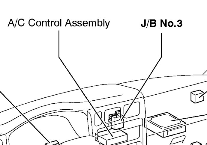

    It's the J/B #3 junction box in the below pic.
    It contains the 3A, 3D, and 3H connectors.

    Before I dig in does anyone know if I have to pull the gauge cluster and all that to get to this?

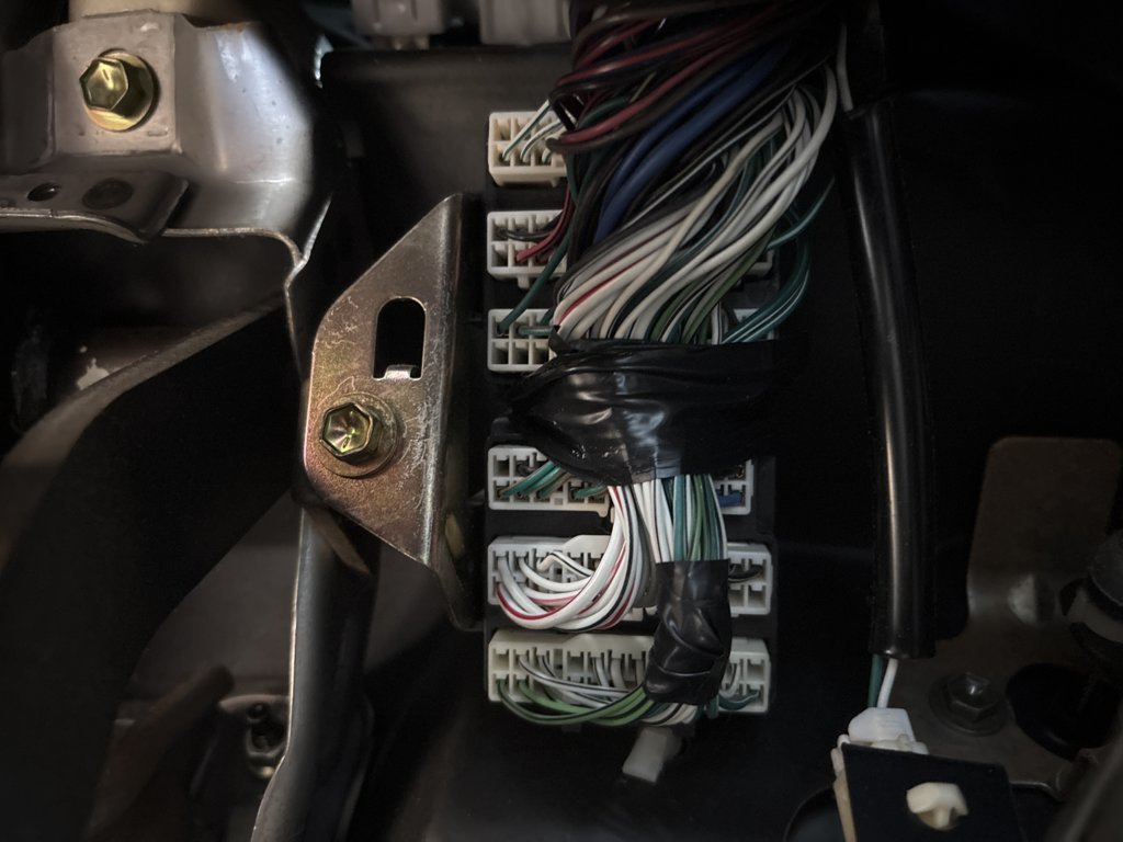

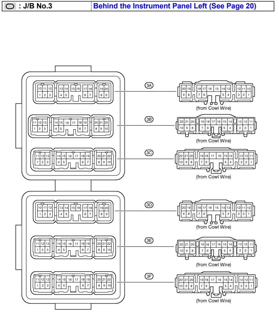

    I can get to this which I assume is 3A-3F but 3G-3I seem to be located somewhere else which makes this confusing

    I found it. It's behind the A/C control switches.
    Probably no fun to get to.
