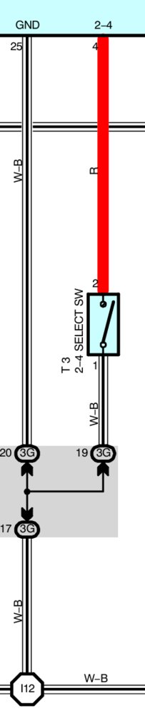

    I know that at least part of the ground circuit is good from the 4WD switch test you did early.
    As the switch shares part of the path with the ECM Ground. See the below snippet for reference.

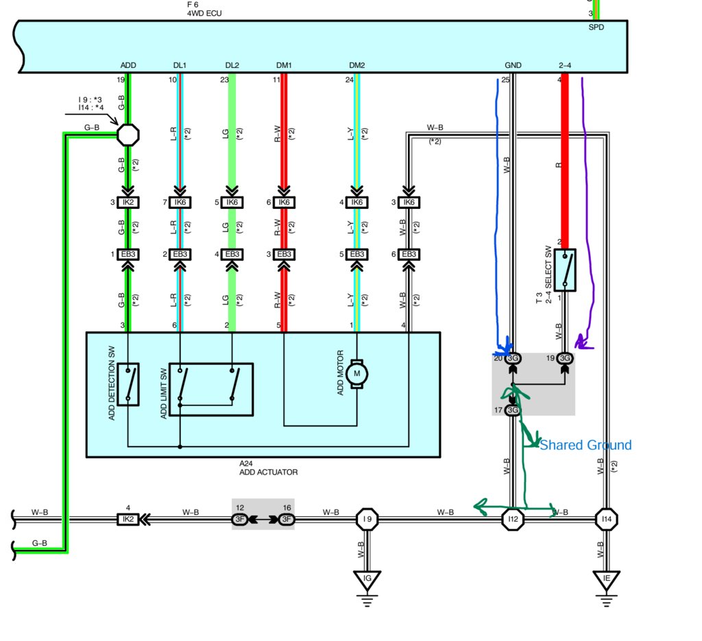

    I may not be interpreting this correctly but does the 2-4 switch share the same ground? Because the ground at that switch seems to be good, which makes me think the disconnect could be right around the ecu. Also do non-4wd things use that junction box/ground? If so wouldn’t they be affected as well?

    They partial use the same ground.
    They both use a different ground to the JB.
    But use the same out of the JB.
    Green line is shared portion of the ground.
    Notice that it ties the grounds together in the JB at the 3G connector.

    If the pin #25 at the 4WD ECU shows no ground.
    Then I say the issues is on the BLUE line path in the above photo.
    Which is, the connection at the 4WD ECU connector, the connection at the 3G connector, or the actual wire itself.

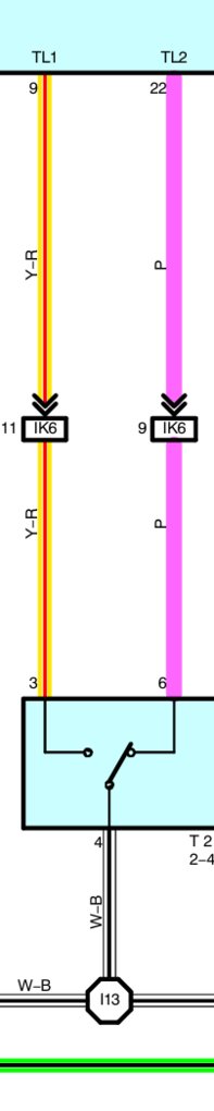

    On the 4WD ECU connector.
    Let's test pins 9 and 22
    9 = Yellow/Red wire
    22 = Pink wire.
    With the Plug, plugged into the 4WD ECU.
    Pin 9 (Yellow/Red) should show aprox. 12v
    Pin 22 (Pink) should be at 0v
    With it unplugged.
    9 should show NO path to Ground.
    22 show Ground.
    After that this check, I'm really going to have to do some thinking.
    I really, really, hesitant to call it an ECU. Especially since we know we had (have) a ground issue.

    Pin 4 (Red) -----------------2-4 Switch
    Pin 6 (Red/Blue) ----------- 2WD Input
    Pin 9 (Yellow/Red) --------- TL1
    Pin 10 (Blue/Red) ---------- DL1
    Pin 18 (Gray) ---------------L4
    Pin 19 (Green/Black) -------ADD
    Pin 22 (Pink) ----------------TL2
