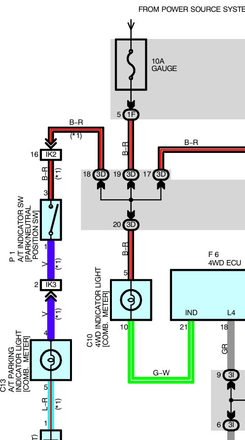

    You say, the 4WD light came on by itself once?
    That can’t really happen. Not without being in 4WD. And not on its own.
    The light for the 4WD is gorounded by the 4WD ECM.
    It possible it’s the ECM, but it is rare.
    like to be sure on the powers and grounds before I’d want to call it that.
    Which is why I want to a few more check (above).

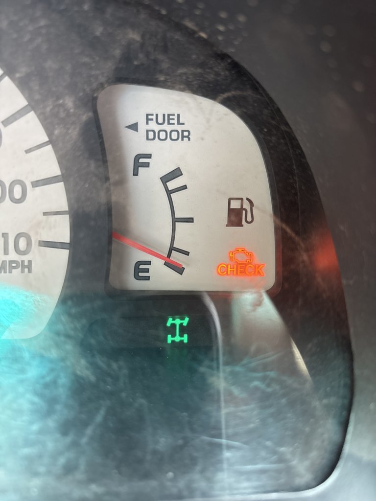

    image.jpgTurns out it was the 4wd ecm. It slips right into 4x4 and I confirmed with the front wheels off the ground. Only concerning thing is it doesn’t blink, just no light then solid light when engaged.
    Dm93 likes this.
  5. Jul 21, 2025 at 3:58 PM
    #85
    Dm93
    Dm93 Test Don't Guess
    Mar 3, 2015
    #150066
    14,074
    Texas
    2014 DC OR 6spd 4x4
    Predator tube steps, Ranch Hand grill guard, Magnaflow CatBack exhaust, Toyota tool box & bed mat, 2LO Module by @Up2NoGood, Rearview Compass/Temp Mirror, Tune by @JustDSM.
    Nice, did you autopsy the old unit?
    The light may not flash if everything shifts right away, it only flashes if it can't complete the shift and/or if there's an error with the limit switches.

    The only wat the 4WD light can come on is through the 4WD ECU.
    The light itself has power to it at all times. But the ECU provides Ground to turn it on.
    And a lot of criteria has to be met before that light can turn on.
    As much as I hate to think it.
    It's looking more and more like an ECU issue.
