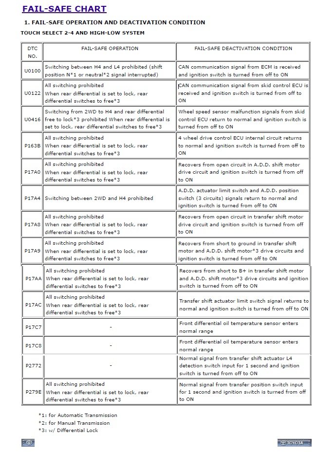

    Just a glimpse of what you're dealing with...
    If you can pull codes, it can narrow it down a little.
    BigWhiteTRD likes this.
