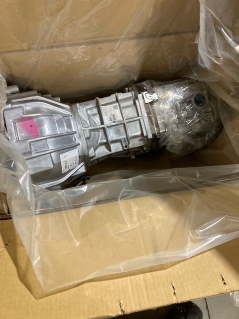

    Yes it is! Manual transmission part no. for your truck is 3303034100 and can be bought from Claremont Toyota for $2,441.88!
    Also I would only recommend swapping in a J-Shift with manual locking hubs for the simplicity of it all.

    Damn, nice!
    Must've been an auto that I remember seeing posted then. It was NOS and I think someone linked it from FB Marketplace some weeks back.
    yotadude520[QUOTED] likes this.

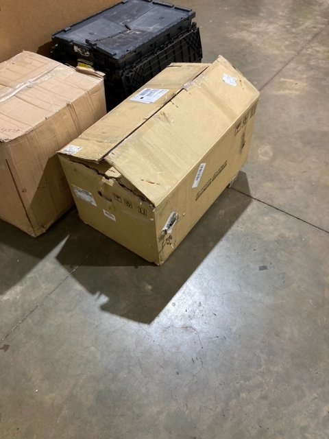

    You can still got those as well! It's amazing how long Toyota stocks parts. Here's how a new tranny from Toyota looks:
    394347d1648311776-bad-lucks-boring-build_2d639267cf55786e1bd54c1af4c33a0583c2df54.jpg 394348d1648311782-bad-lucks-boring-build_a2de87b7a70d1f8b7cc7063c8ecc51981d5958fd.jpg
    Mac. and Kwikvette[QUOTED] like this.
