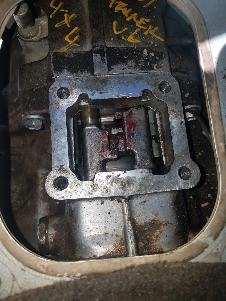

    So my swap is complete but I'm having some issues with my shifter. It got stuck in 4 hi and I can't get it out of 4 hi like phisicly able to shit back I to 2hi. This ever happen to anyone?

    Are you sure you have the shifter placed in the proper position ? There is a square hole that the shifter fits into that allows movement of both shifter forks . Sometimes , guys accidently put the shifter into the transfer case while the transfer case is already in gear . The transfer case needs to be in nuetral when placing the shifter back into position
    https://www.tacomaworld.com/threads/transfer-case-transfer-cases-in-first-and-2nd-gen-trucks.345652/
    https://www.tacomaworld.com/threads/wont-shift-to-4wd.525927/

    My forks are stuck and won't move. I have the vacume line disconnected when I tried it. Could that be an issue?

    Connecting the line wont help your issue . Did you get that case for a good deal ? It has mechanical issues .

    Am I crazy or is that t-case missing the spring that keeps the shifter in correctly?

    I took out the spring and yea I got it for 10 bucks lol
