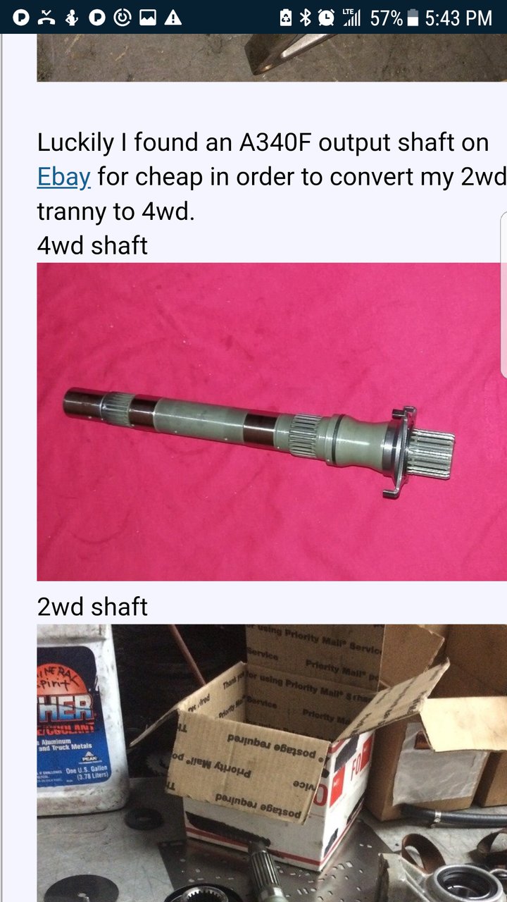

    So just fro. That pic u can tell it's broken

    I swapped output on the trans

    Oh yeah... what output shaft did you use?

    I'm totally confused, why did you have to swap the output shaft? Did you use an A340E instead of an A340F?

    Well I must have been a two-wheel drive because they told me that it was a 4 by 4 and it wasn't the output shaft was just a bit too long about 5/8 of an inch longer

    That is super confusing, because if it was the A340F it would have the correct output shaft. There is a difference between v6 and I4 though. The I4 has an extra coupler in between the transmission and the transfer case due to differences in engine length I believe? Maybe that was why it was longer the A340F came off an I4 not a v6
