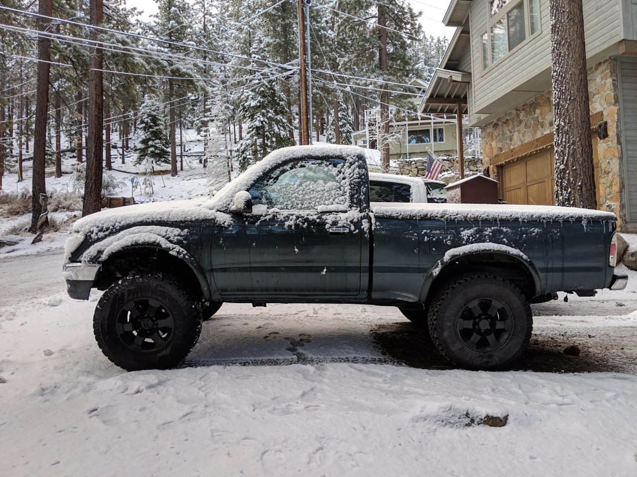

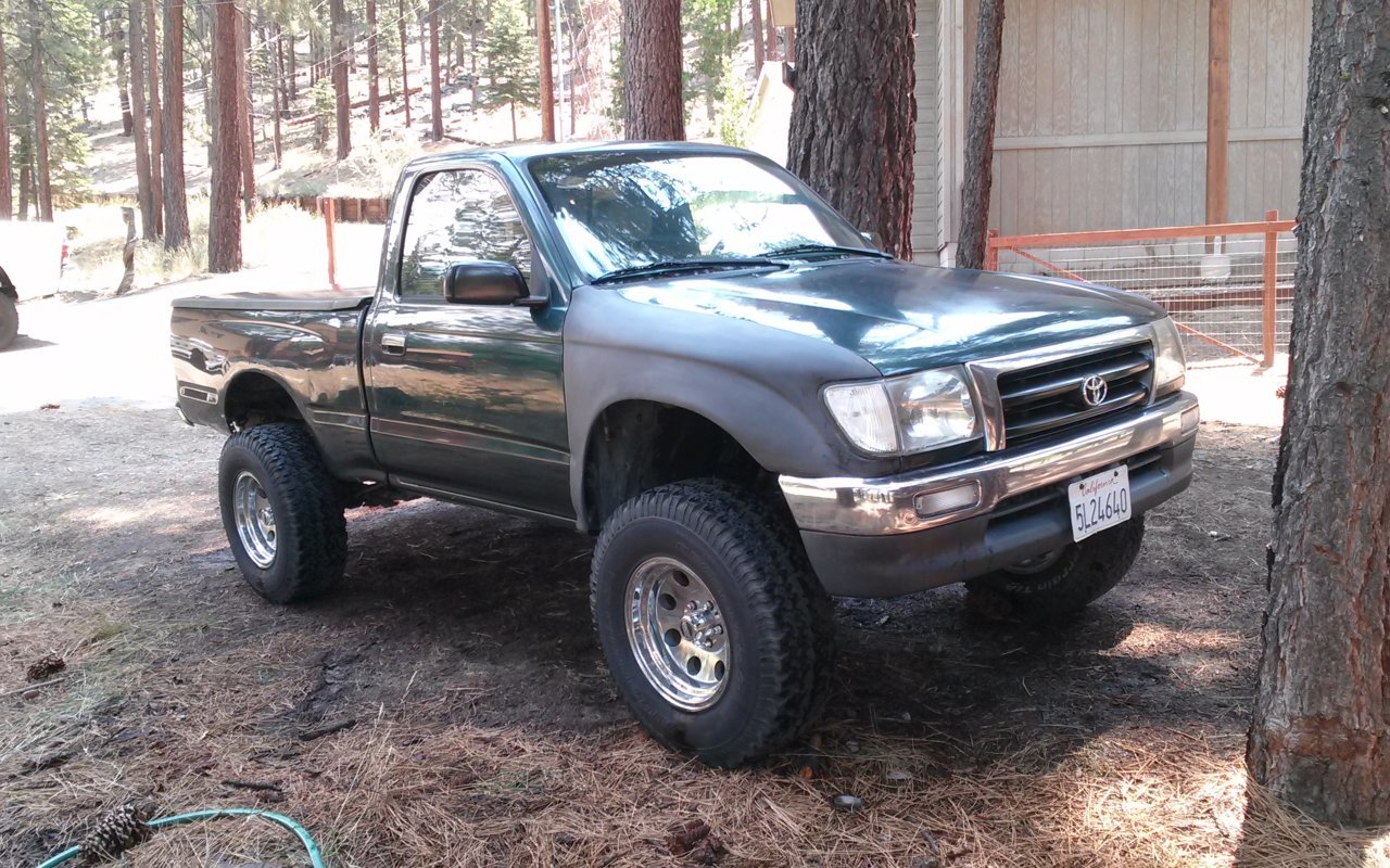

    Its still possible with a 5lug. Just a lot more parts you need like a new frame. Took me a week to do the actual work and with only basic tools and a shit tun of tree rounds.
    Before.
    after
    jeg0005, Area51Runner and cruiserguy like this.
