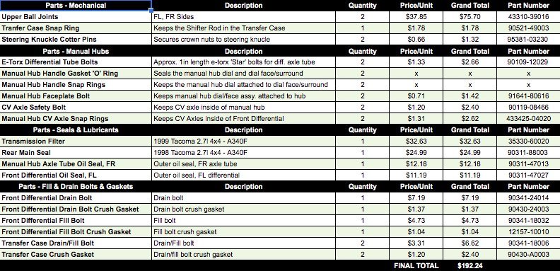

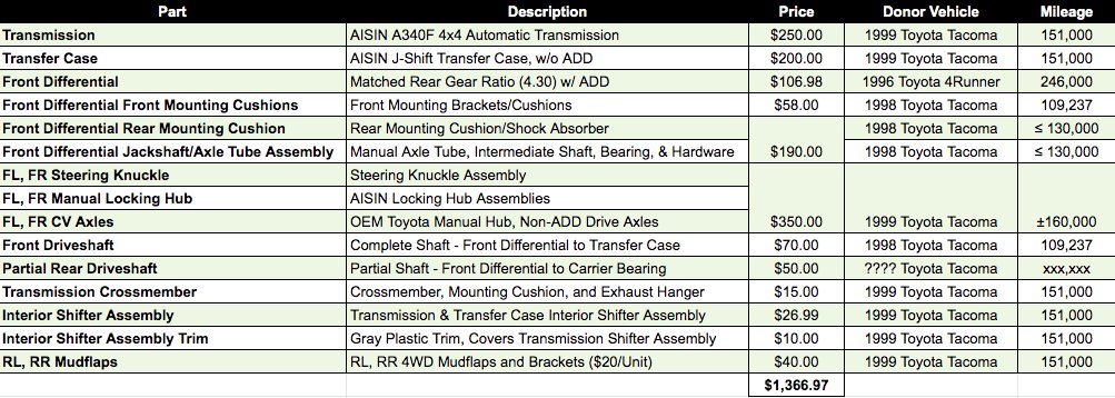

    I’m working on this project slowly still and was looking over this list you made. Did you go to salvage yards to pull these yourself or were you able to source these from websites or what? I’m trying to find parts but man it’s tough in my area. Not many tacos in salvage yards within 500 miles according to the row 52 app.

    This is awesome! Thank you! Now I have to figure out what the actual names of the parts are according to the website. I didn’t find a “j shifter” on there.

    You’ll find them standard on 1995-2000 trucks.

    Ok. Perfect. Thank you. I still have some learning to do though. I don’t see cv axel or manual locking hubs. I’m sure it’s on there I just have to learn the terms. My lack of mechanical experience is making this much harder than I imagine it needs to be.

    You need to buy the entire steering knuckles unless you want to press them in and out.

    Argh! Man this is frustrating. Ok.. thank you. The terms are gonna be the death of me. I don’t even know what this stuff is. I just need to find someone to source the parts for me. That car parts website is awesome though. Looks like a place in Joplin mo (an hour away) has some Tacoma’s that may have my parts but the terms are slowing me down.

    Full conversion package? I’d say maybe $1,000.
    $10 if you’re talking about yours that swam in poop water.
    Jojee117 likes this.
  16. Jun 4, 2019 at 5:04 PM
    #96
    Tour991
    Tour991 Supplier of used parts
    Nov 24, 2011
    #67616
    10,964
    James
    South Reno/Tahoe
    97 2/4wd, 2014 DCLB 4x4, 99 T4R Limited (sold) 2024 4runner TRD Pro
    Id say more then that. If you sell it as a conversion package everything induced you could get $1,250 or more .
    a340 trans/t-case $600
    front drive shaft $80
    vacuum add diff $250
    cvs $100
    spindles $300
