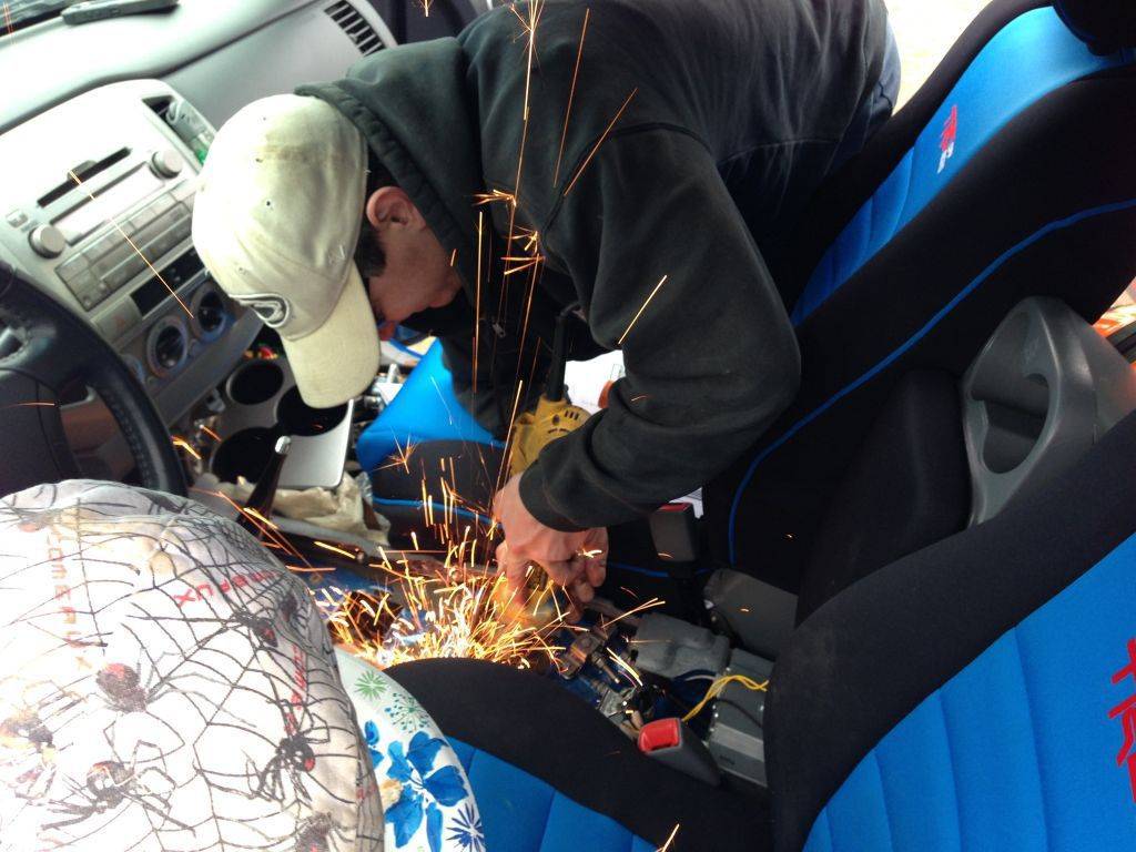

    So not to bad for someone with mechanical skills? Because I have limited mechanical skills lol. Id prob have to pay a shop to install it for me

    I dont mind cutting on the truck at all. Now welding...not my forte. Lol
