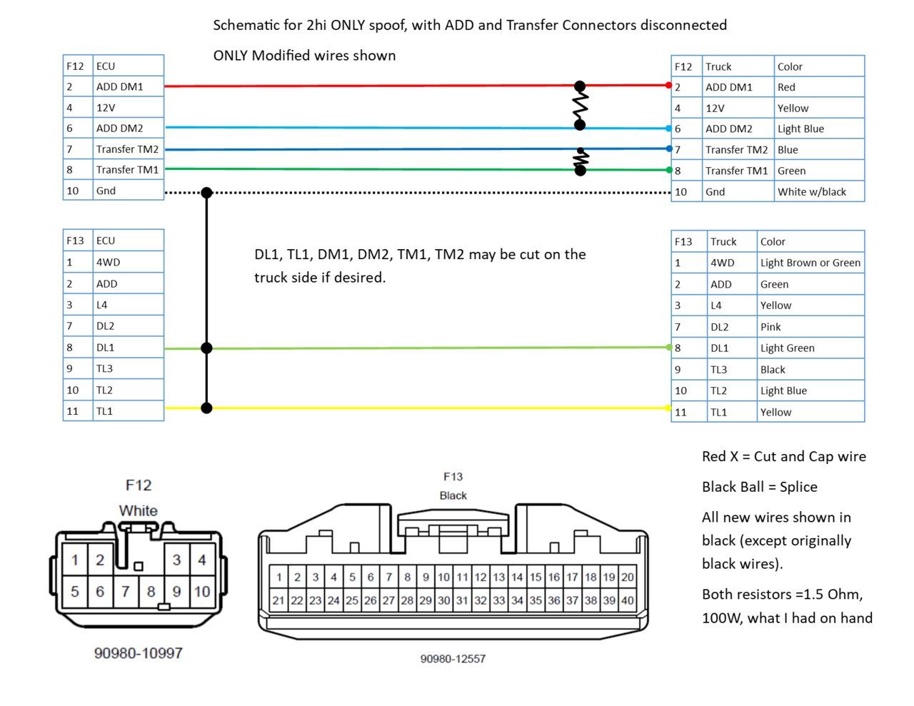

    So if we leave the ECU permanently in 2hi you won't have 4wheel traction control (we think). You would have these 2wd modes available
    1. 2Hi TRAC ON and VSC ON
    2. 2Hi AUTO LSD. In this mode VSC is off from 0-30mph and on over 30mph.
    3. 2Hi TRAC OFF and VSC OFF​
    We could leave the ECU permanently in 4hi, and you get 4wheel traction control, but the modes are not the most useful (traction control ON but VSC OFF is useful)
    4. 4Hi TRAC ON and VSC ON.
    5. 4Hi TRAC OFF and VSC ON. In this mode TRAC is off from 0-30mph and on over 30mph.
    6. 4Hi TRAC OFF and VSC OFF​
    You could leave the ECU permanently in 4lo, but i believe that will eventually give you errors.
    So this is the issue that resulted in me designing the 2mode spoofer (goes from spoofed 2hi to spoofed 4lo).
    That is the schematic on first page.
    If you think you want to leave the spoofer in 2hi, 4hi, or 4lo permanently, can simply that schematic...
    Does that make sense, I want you to understand the options and drawbacks first.

    Just to be clear, if you permanently spoof into 2hi, that means you wont have any front axle traction control when you manually activate the transfer case and front ADD. (as best we can tell)
    I will need to double check the schematic when not tired, but the short answer is that you will use the schematic from the first post, however you can omit the relay and instead just permanently ground pin 8 and 11 on connector F13 (the second connector interconnect shown)
    I will try to simplify it tomorrow (Sunday later today actually), if you think you just want permanently 2wd on the ecu.
  9. Jul 18, 2021 at 9:50 AM
    #29
    Dkarr13
    Dkarr13 IG: Tonya_Tacoma
    Nov 28, 2018
    #274087
    429
    Ohio
    2016 Sport MT ACLB MGM
    Too much to name for this little space
    I double checked and yes I'm fine with losing (as far as you know) traction control on the front in 4hi. Were you able to simplify the schematic at all? I'll probably toy around with that this next week. How many people have you talked to that have a swapped 3rd gen?
  10. Jul 18, 2021 at 1:30 PM
    #30
    BigWhiteTRD
    BigWhiteTRD [OP] Official thread killer (only crickets remain)
    May 24, 2017
    #219848
    1,673
    Ted
    Treasure/Space Coast Florida
    2017 AC TRD OR Auto 4wd, 2012 AC SR5 4.0 MT 4wd
    The only person I am aware of that I eventually assisted in the FJ swap electronics is @Bajataco358. (I am not aware of anybody else I gave guidance or suggestions to utilizing them, although they may have... per my memory). I have helped alot more people work on anytime locker for pro/OR, so its possible I am forgetting somebody for FJ case assistance.
    I have revised the schematic with the following assumptions
    Truck ECUs will ALWAYS think they are in 2hi
    Truck dash dial MUST ALWAYS be left in 2hi
    The transfer case actuator and ADD actuator connectors must be completely disconnected and insulated (not shorted out to anything, bagged and stowed).
    (Let me know if these assumptions dont match your reality, such as any special ADD harness, etc.)
    Note,
    The wiring connections shown can be made at the ECU, or at the actuators, or literally anywhere electrically connected, but DO NOT allow grounding of any wire not explicitly annotated as grounded.... The ECU checks for current leakage to ground on the actuator circuits.
    This schematic shows the connections (pin numbers and colors) at the ECU, let me know if you want to connect at the ADD or transfer actuator.
    The resistors shown need to be power resistors, IF there is any risk of ever turning the truck dash dial. These resistors will see 12V if anybody ever turns that dash dial. The ECU will fault after a few seconds, but it will have quite a wattage into the resistor until then.
    THIS SCHEMATIC NOT PEER-REVIEWED YET. USE WITH CAUTION. I AM NOT LIABLE IF THIS TORCHES YOUR TRUCK. I recommend double checking this data against the data in this thread before use (https://www.tacomaworld.com/threads/4wd-actuator-troubleshooting-transfer-case-and-add.578262/)
    If any of this doesnt make sense, or these assumptions dont match your reality, please ask before chopping wires.Spoof schematic TS 7-18-2021 2Hi ONLY.jpg

    Yes both actuators are disconnected so the actuator wiring harnesses coming out of the ECU does not connect to anything on that end- they're just hanging now. I need some ideas on how to bag them though because I don't deal on much electronics.
    As for the schematic, awesome. I'll open up to the ECU and see if I can at least point out wires I'll need to change and send pictures before I touch anything. Do you know the resistors you recommend? I'm actually a mechanical engineer so I've only ever dealt with this stuff on paper and not sure what the industry standard is or if the resistors I've dealt with were just a university thing

    I would fill the connectors with dielectric grease (like bathed in it), which is available at auto parts store or in electrical section of home improvement store. Get a heavy duty polyethylene bag (like a vacuum sealing bag or double up ziplocks) and just secure it with a tie wraps over the connector. That should be ample for this usage in my opinion.
    For resistors, I would just search Amazon for ~1.5 ohm 100w wire wound resistor, should get (2) for ~$6-8. (On phone now so pain to get a link). Those will need to be soldered and heat shrinked to some wire (do that outside the truck.)
