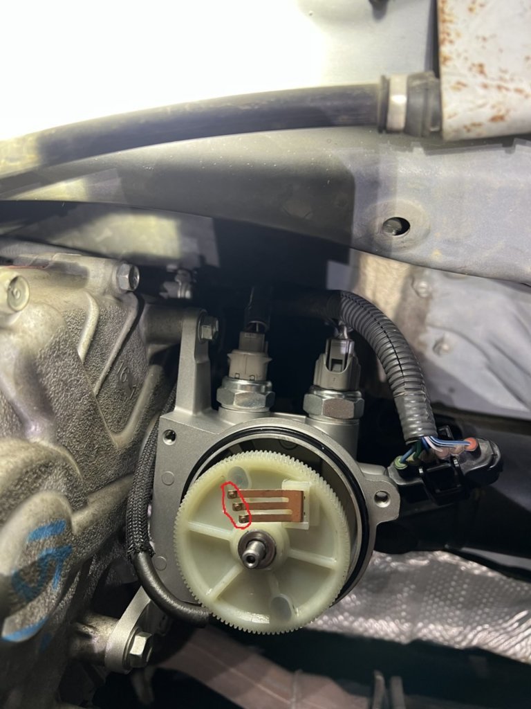

    Like many, I’m dealing with the dreaded flashing 4WD light. I’ve read through a bunch of threads and haven’t started blindly replacing parts — I’ve been methodically testing everything with a multimeter to trace the issue.
    I’ve confirmed the truck is in 2H, and the front driveshaft spins freely, so the transfer case isn't engaging.
    Here's where I'm at:
    • The break seems to be at the TL2 and TL3 position sensor circuits
    • In 2H, the ECU should see 12V at both TL2 and TL3
    • Instead:
      • TL2 is showing 0V at the ECU
      • TL3 is showing ~7V at the ECU
    • When I probe the sensor plugs directly, both TL2 and TL3 are only getting ~7V
    So I’m seeing:
    1. Low voltage across the board to the TL sensors (they should be getting 12V)
    2. A broken signal wire between TL2 sensor and the ECU (7V at the sensor, 0V at ECU)
    This strongly points to an electrical issue — not mechanical — likely a bad splice or broken wire in the harness. I followed the loom up along the transmission and across the firewall but haven’t visually found a break yet.
    Also worth noting:
    • No relay clicks
    • Nothing happens when attempting to switch modes
    My questions:
    • Where exactly does the 12V feed to the TL position switches come from?
      • Is it tied into the 4WD relay, ignition circuit, or something else?
    • Has anyone had a similar issue with a broken TL2 signal wire? Any known failure points along the harness?
    Any insight would be seriously appreciated — I’m close, but hitting a wall tracking this last part down.
    Thanks!

    Yes, I've looked at that thread, and as mentioned, I'm getting 7v at TL2 and 3 plugs on switches, but at the ECu, I'm getting 0v and 7v, so it is 100% an electrical issue. From my understanding, it's actually the opposite. The sensors are connected to a 12v source, and the sensors send the signal to the ECU; the ECU doesn't send the 12V to the switches.
