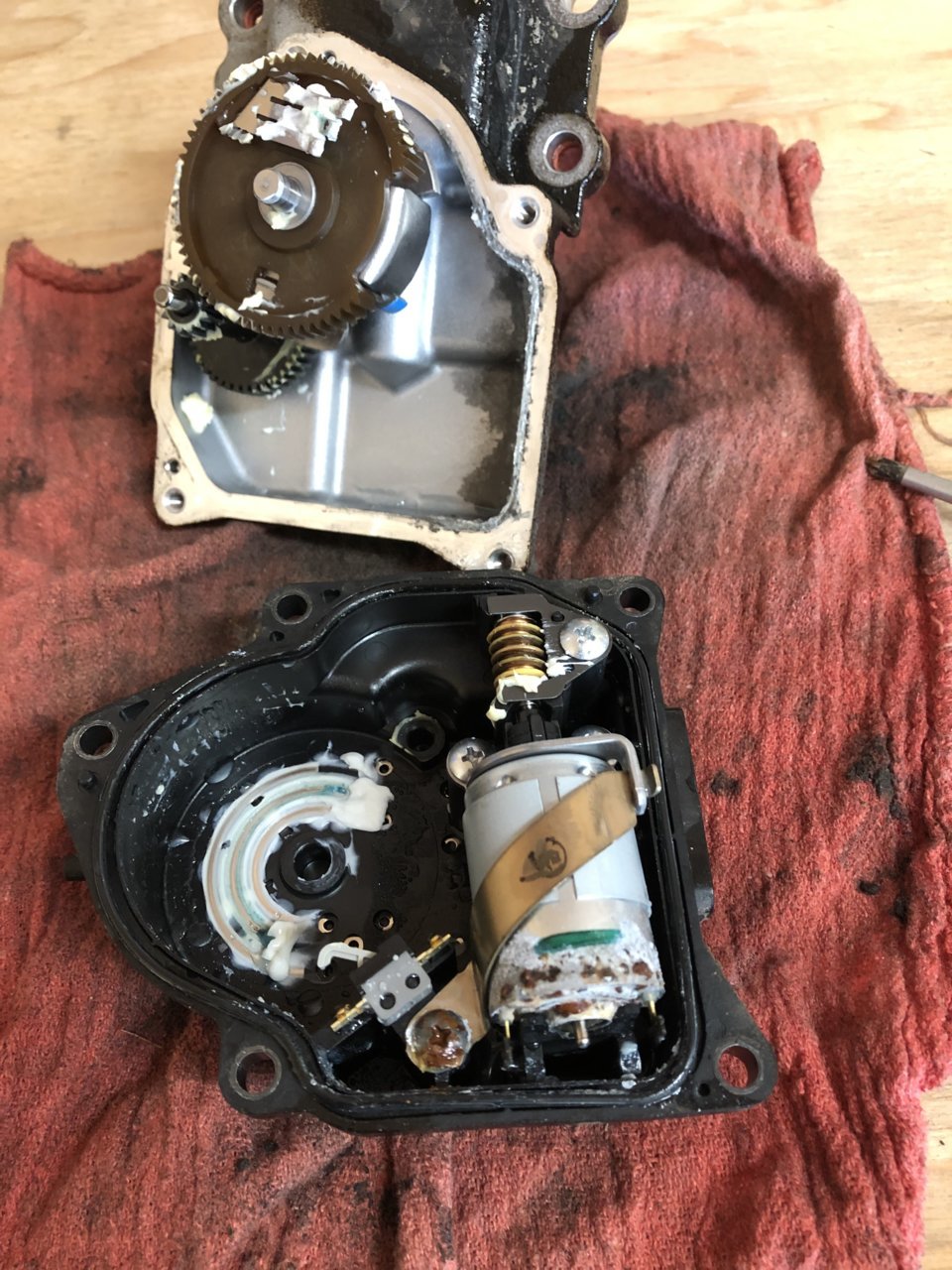

    Update: Fixed! Took the ADD actuator off, disassembled it and dumped the water out for starters. Thing was nasty and corroded inside. That factory seal is a joke. Cleaned it up, soldered the connections covered them all with dielectric grease and then put that thing back together with an excessive amount of RTV. It will NEVER leak again. Working flawlessly now.
    Think this might have been my issue? Damn thing is 6 months old.

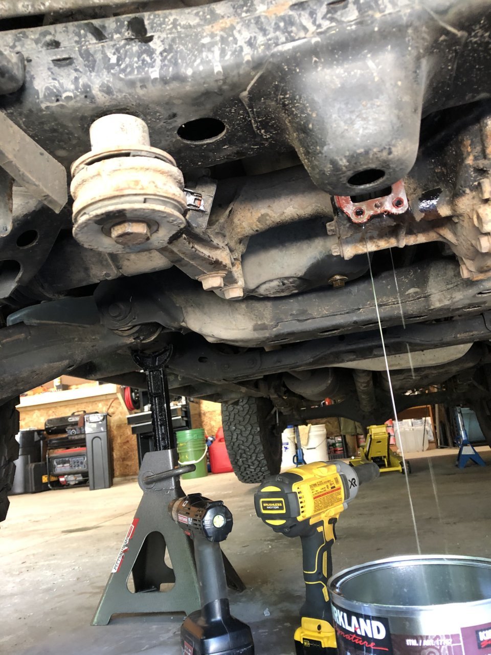

    Note for future TW members with this problem. Actuator is a bitch to get out. The process is made so much easier by loosening the diff mount. It allows just enough play in the diff to make removal possible. Also don’t forget Your breather hose. Be gentle removing it and don’t forget to reconnect.
