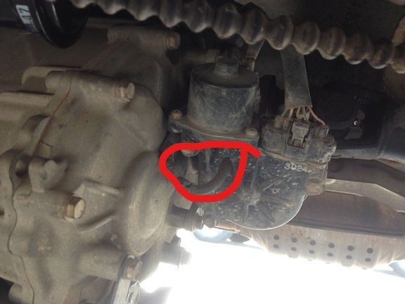

    Is the 4wd actuator and transfer case actuator the same thing? I have replaced the 4wd actuator. Here’s a picture of the part I replaced already

    That is the ADD (Front Axle Disconnect) actuator, the Transfer Case Actuator is on the back of the transfer case.
    The vent hose I was talking about is circled in red.

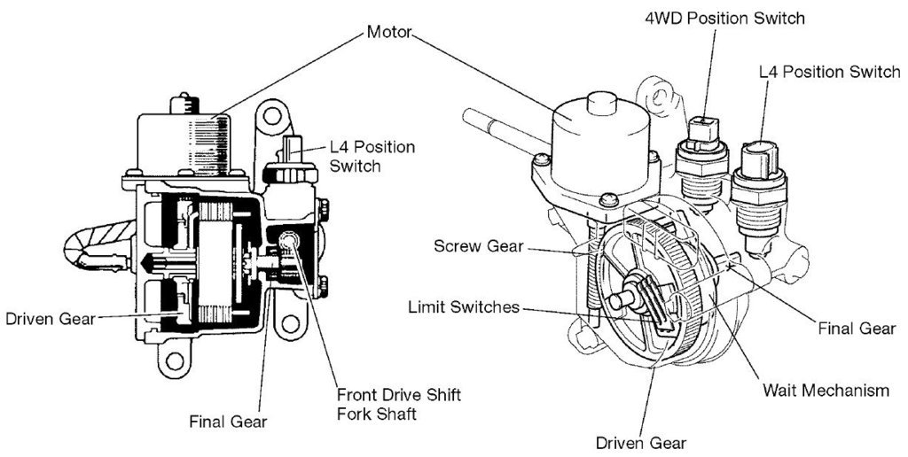

    Internal drawing of it.

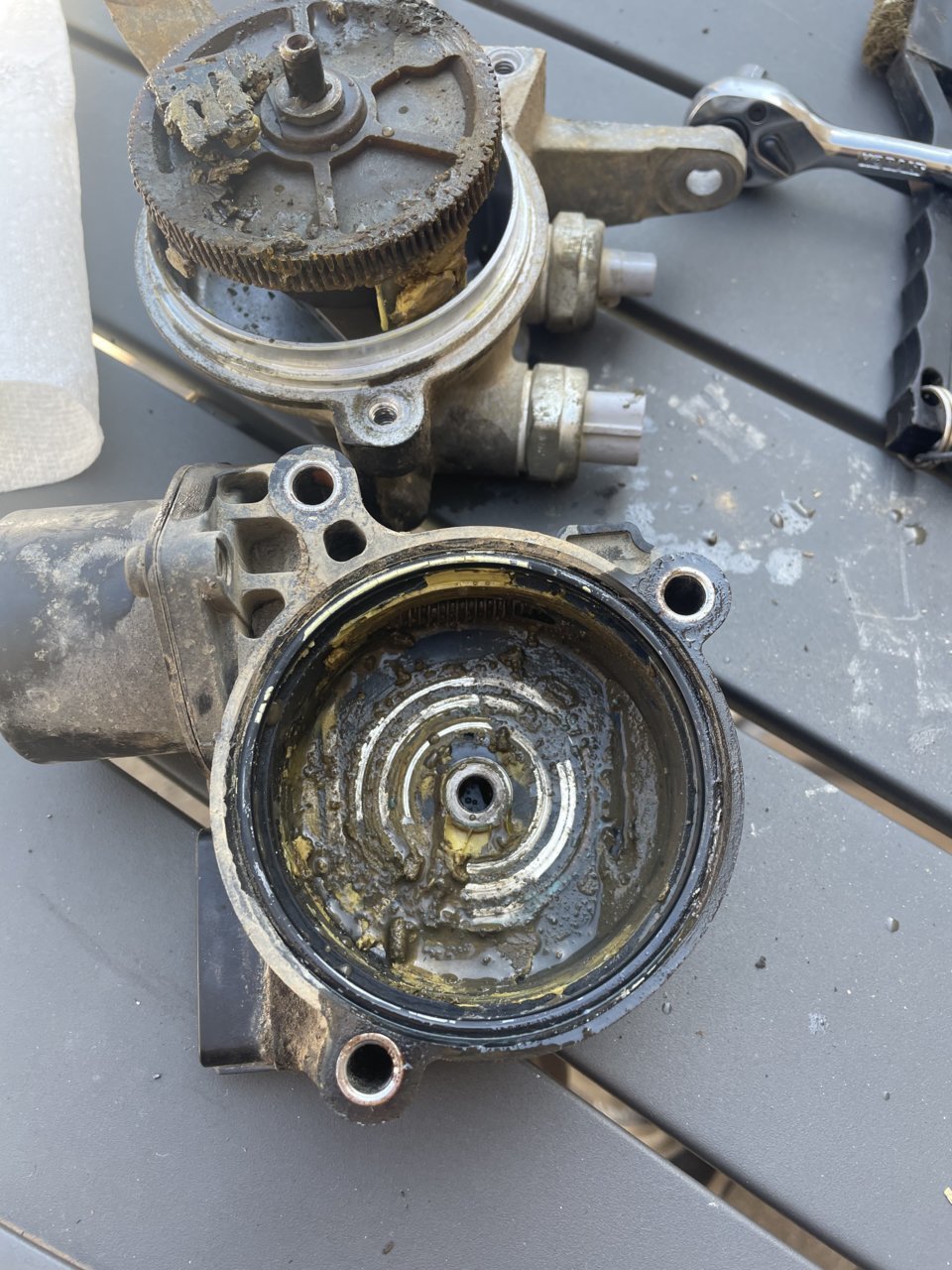

    We’ll, this is definitely the problem. I removed the transfer case actuator and opened it up. It is full of water and mud. The breather tube was also try rotted and split. I’m going to try to clean it up and degrease everything. If that doesn’t work out then I’ll end up replacing it. Thanks!

    Make sure you get it timed correctly when you put it back on.

    I marked the gears locations before I took it apart. I’ll update when I get it back in.
