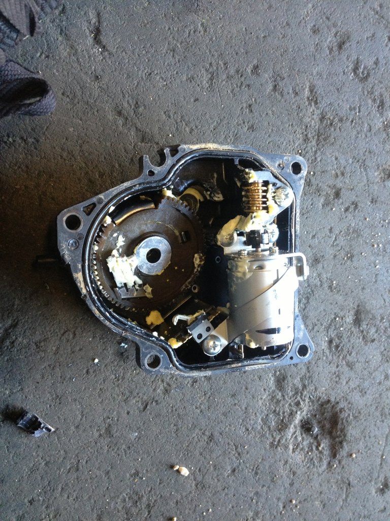

    #20
    blackhawke88
    blackhawke88 wo ai ni bao bei ^_^
    Jan 11, 2009
    #12478
    16,663
    SGV, CA
    07 TRD Offroad
    Trouble shoot your actuator first. I took mine apart and found out the prongs on either side of the actuator motor were bent apart. I soldered them together and it worked:
