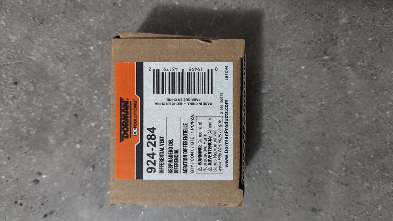

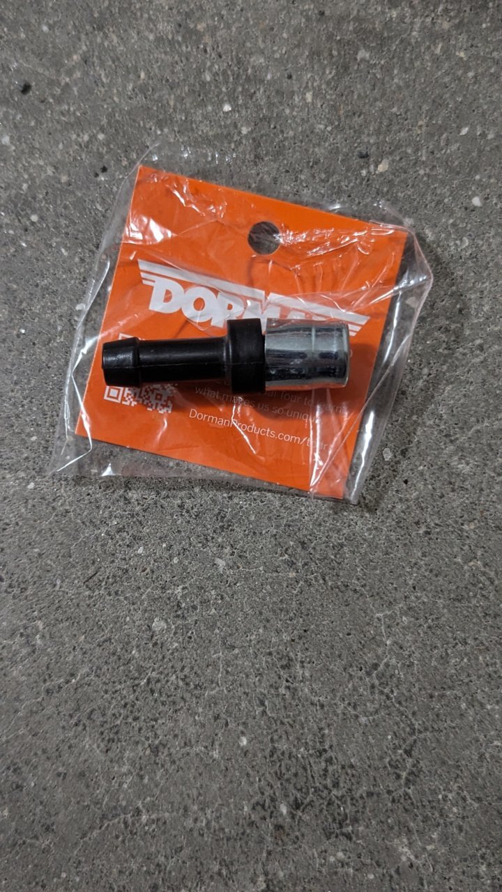

    Use a 2 way breather, otherwise it will be a useless mod. Using a 1 way breather (like what is stock) will not prevent water intrusion when the diff cools off under water and creates a vacuum inside. You'll pull in water from the axle seals.
    This is the breather, it's a 2 way

    That's a 1 way breather per Dorman. Designed to match the design and function of the stock breather.

    To double check, I put it in my mouth and air passed through both ways. If it is a one way, it's not very effective.
