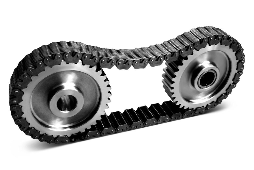

    They don't explode. In rare cases you may break a U-Joint or front drive shaft. Yes, I've seen it happen. But the most common problem is that every time you place the drivetrain in a bind the chain inside the transfer case stretches a little bit. Over time it will stretch enough to start slipping on the gears when under a load. BTDT and paid to have a transfer case rebuilt. Twice.
    There are times when you need to use 4X4 when on dry hard pavement, and this is one of them. If the hill is that steep there will be very little weight on the front axle and it should be pretty easy for you to get some front wheel slippage that will prevent binding the driveline. You can get away with doing this for a while, but I don't advise doing it any more than necessary.
