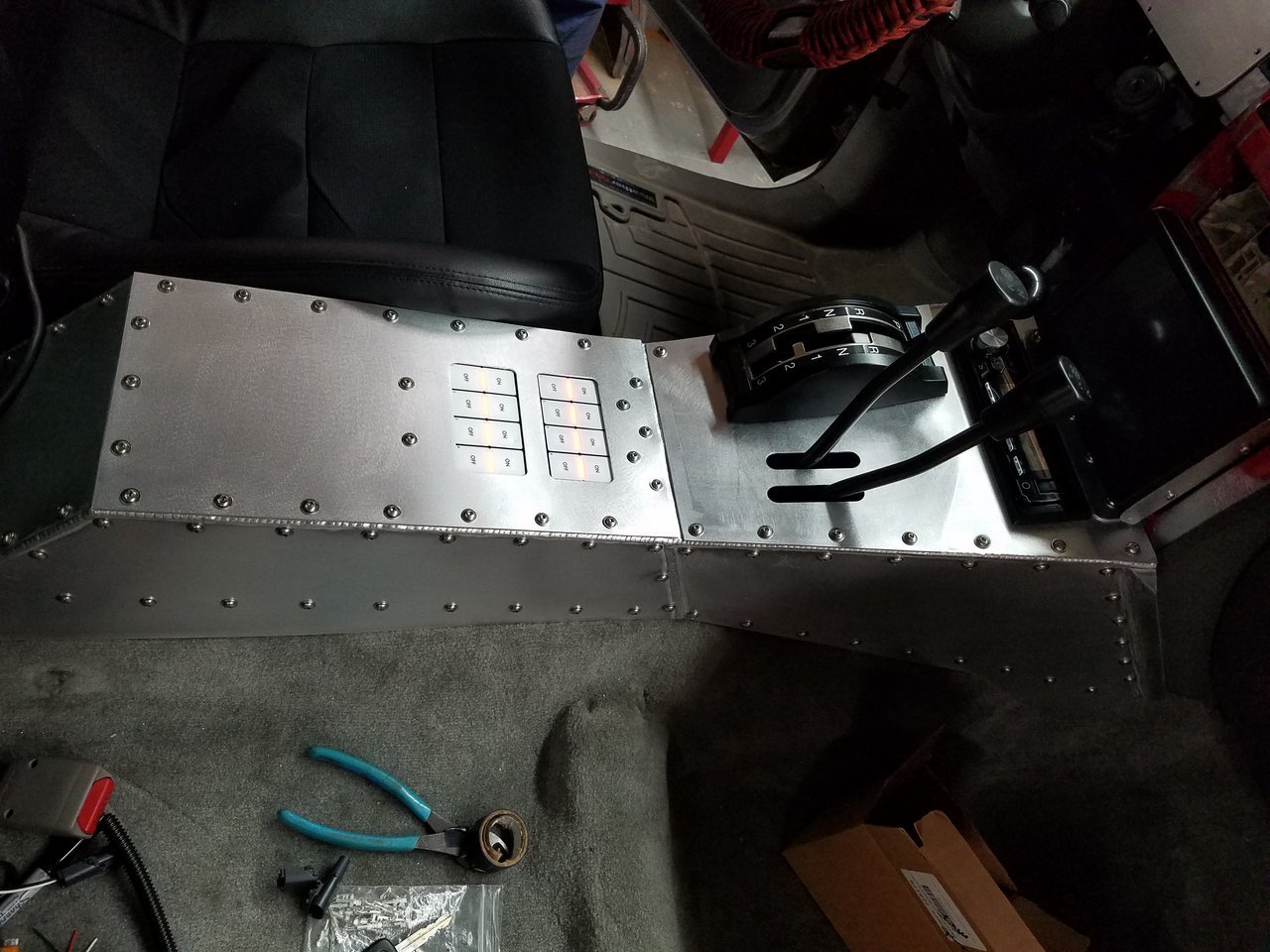

  6. Aug 5, 2017 at 6:04 PM
    #306
    Long_Travel_2002
    Long_Travel_2002 [OP] Well-Known Member
    Feb 22, 2016
    #179105
    572
    ivan
    memphis
    2002 tacoma LSA swap prerunner
    built supercharged LS, T56, Linked, caged.
    Center console is now done! Went for a little drive around the neighborhood. 20170805_171250.jpg
    Peep the new daily in the background. As of now the truck is basically done. We have a few more small details to attend to and the LS swap will be 100% done! Next step - cage, and 5 point harnesses:oldglory:

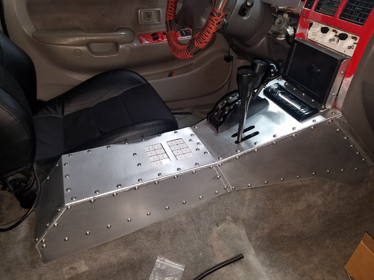

  11. Aug 6, 2017 at 10:11 AM
    #311
    Long_Travel_2002
    Feb 22, 2016
    #179105
    572
    ivan
    memphis
    Here is a better picture of the console

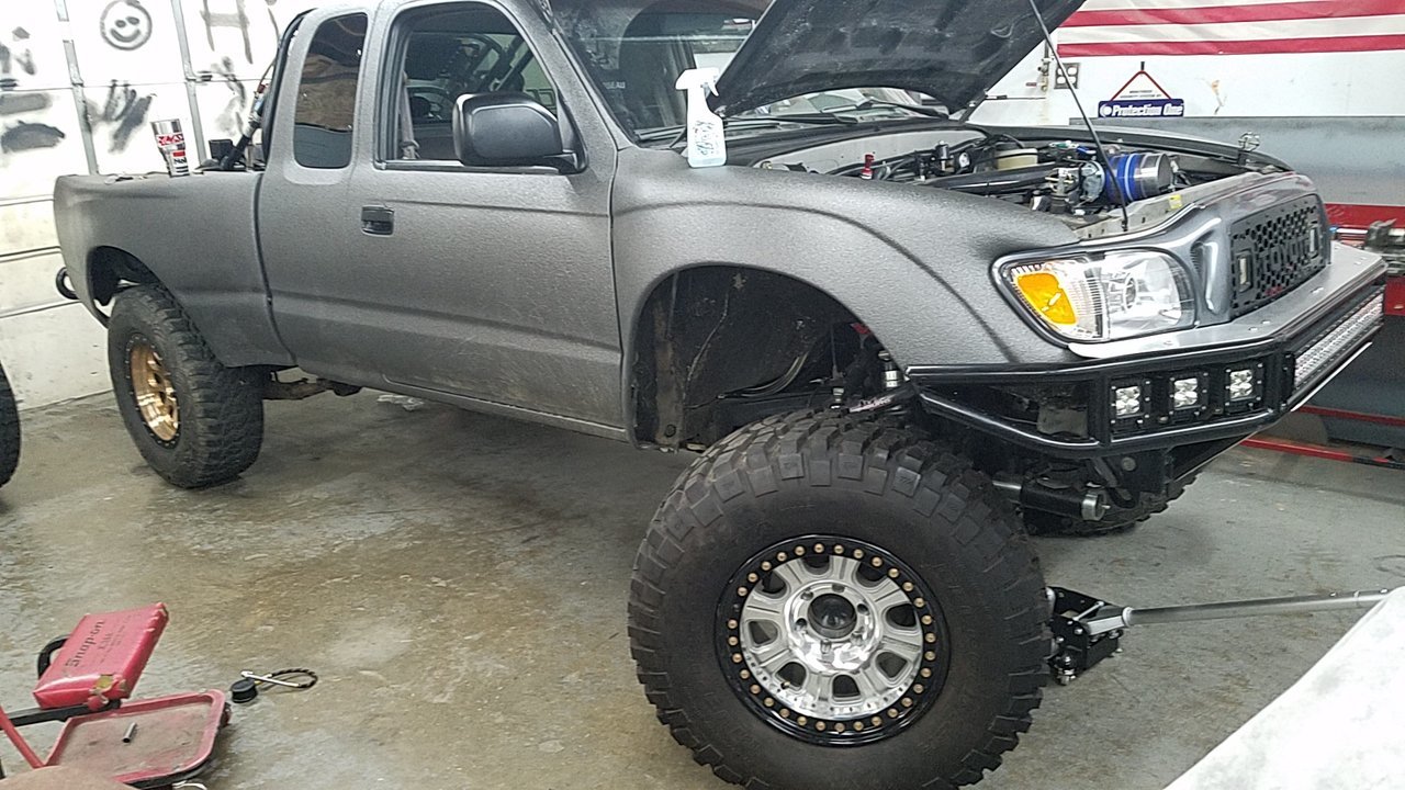

  12. Aug 13, 2017 at 2:49 PM
    #312
    Long_Travel_2002
    Feb 22, 2016
    #179105
    572
    ivan
    memphis
    So as of now i am starting to build up my 9 inch for the rear end. We have most of everything we need, just need axle shafts. Also have a few new things coming up.
    Big brakes
    And 35s on raceline beadlocks

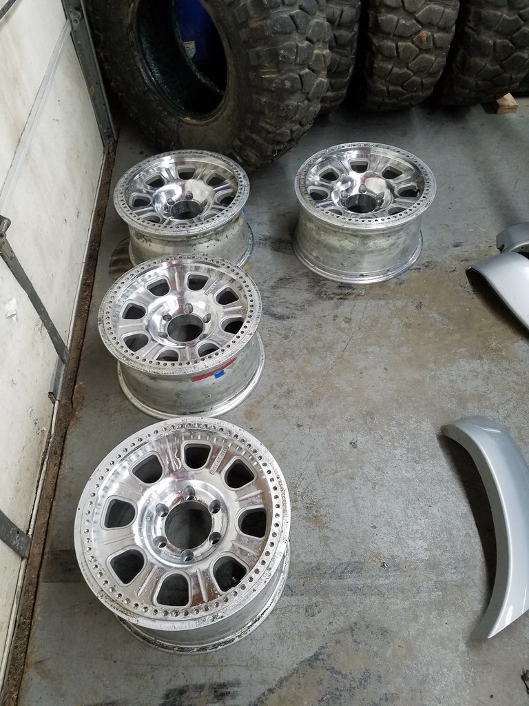

  15. Aug 14, 2017 at 8:36 PM
    #315
    Long_Travel_2002
    Feb 22, 2016
    #179105
    572
    ivan
    memphis

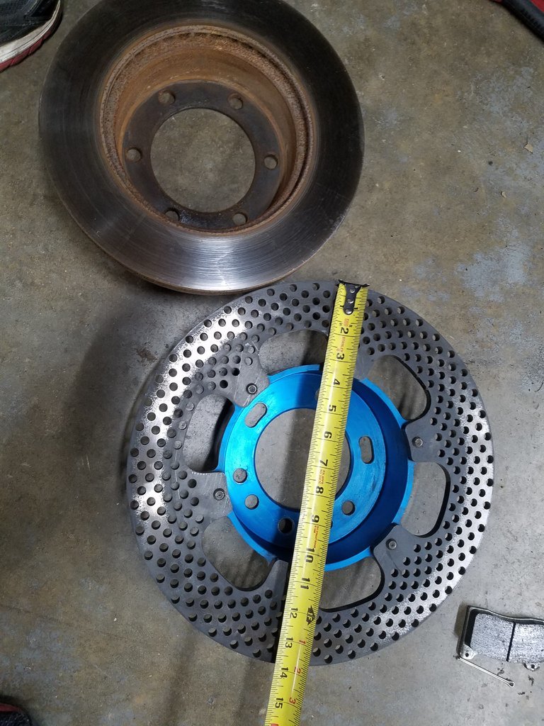

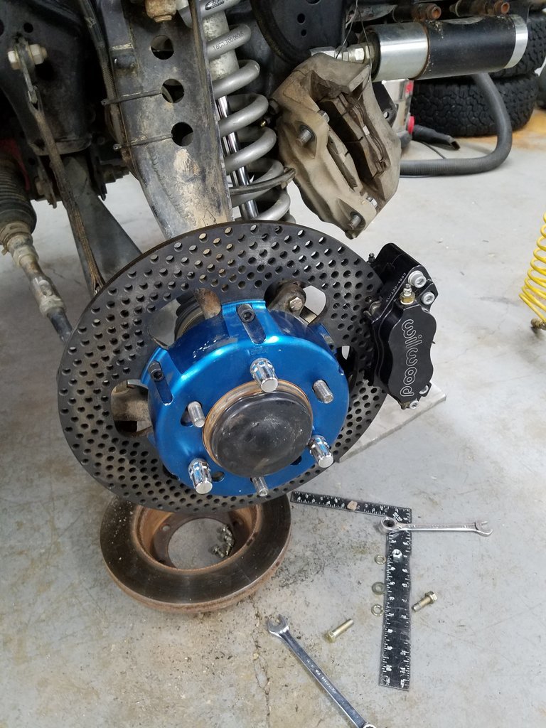

    Cleaned my raceline beadlocks since they are used. They came off our rock buggy. Picking up my new tires tomorrow and hopefully polished beadlock rings to replace the beat up steel ones.
    Also my big brake upgrade is going to be fairly straightforward. Rotors are the same offset as stock so all we gotta make are some brackets for the willwood calipers, which they almost fit in the stock location so the brackets will be easy. I will also be putting these 14 inch rotors on the back when we build up the 9 inch. All i need for it is axle shafts and to lengthen a housing we already have. :thumbsup:20170814_194005.jpg

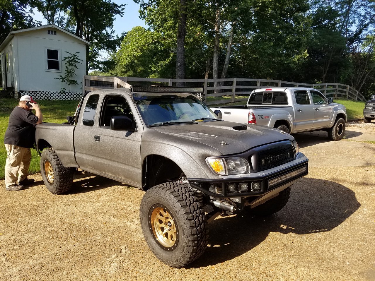

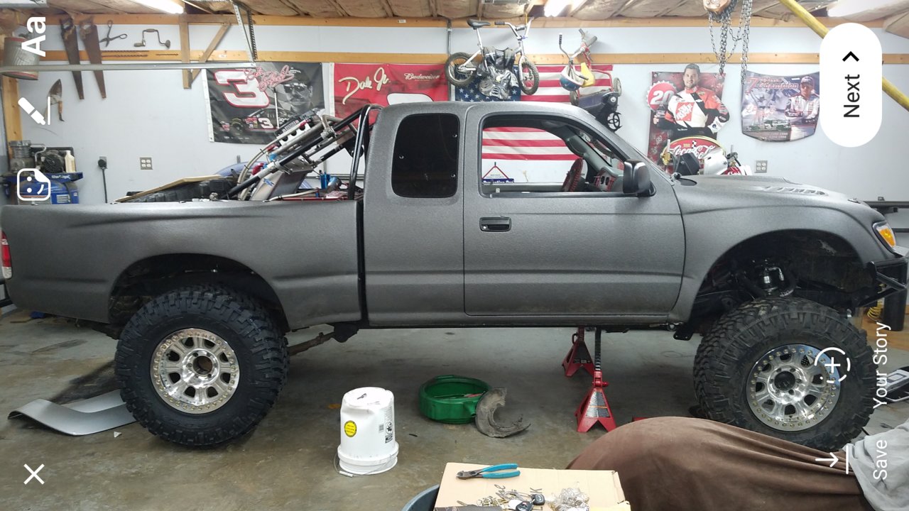

  16. Aug 15, 2017 at 7:26 PM
    #316
    Long_Travel_2002
    Feb 22, 2016
    #179105
    572
    ivan
    memphis

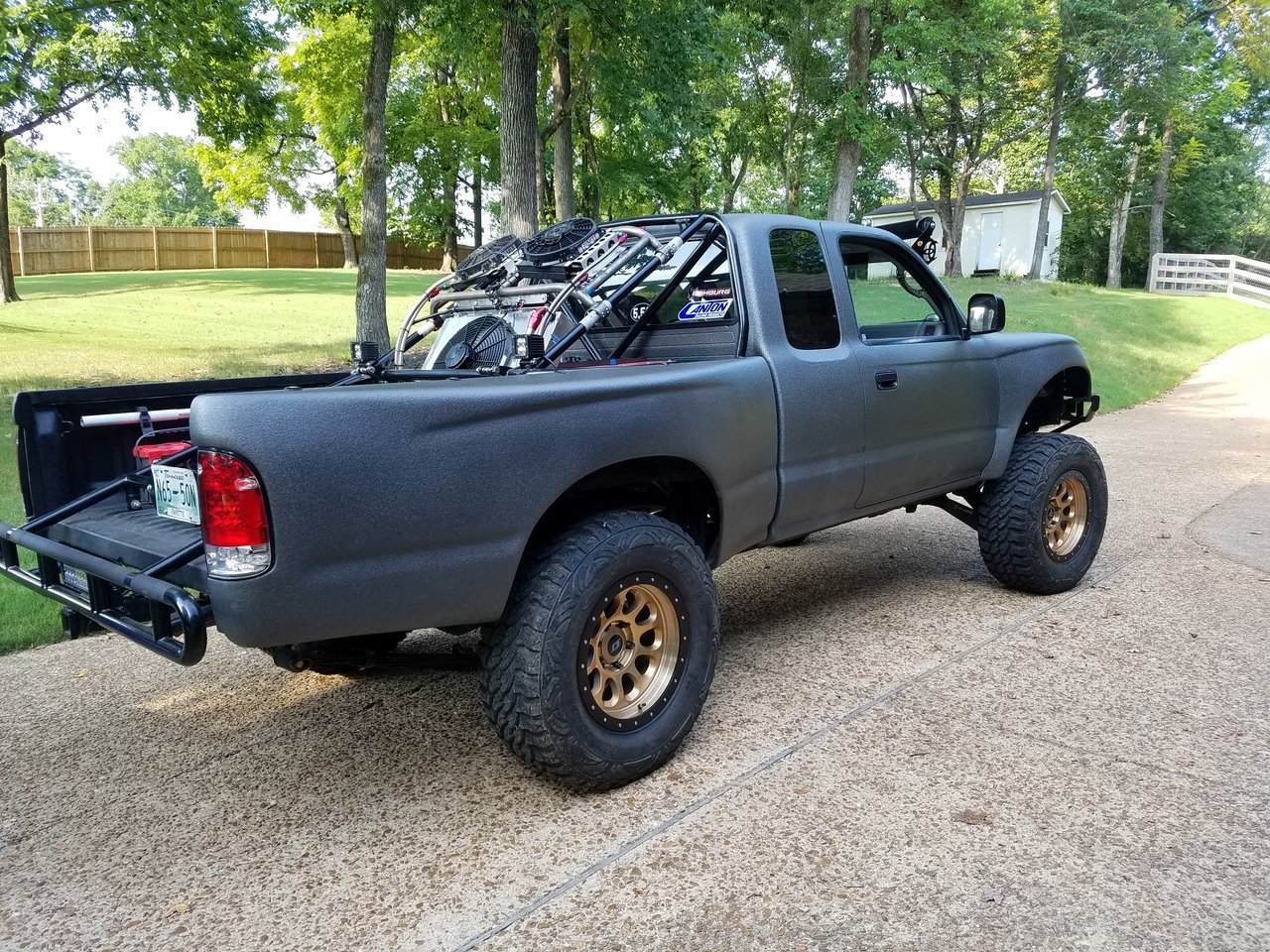

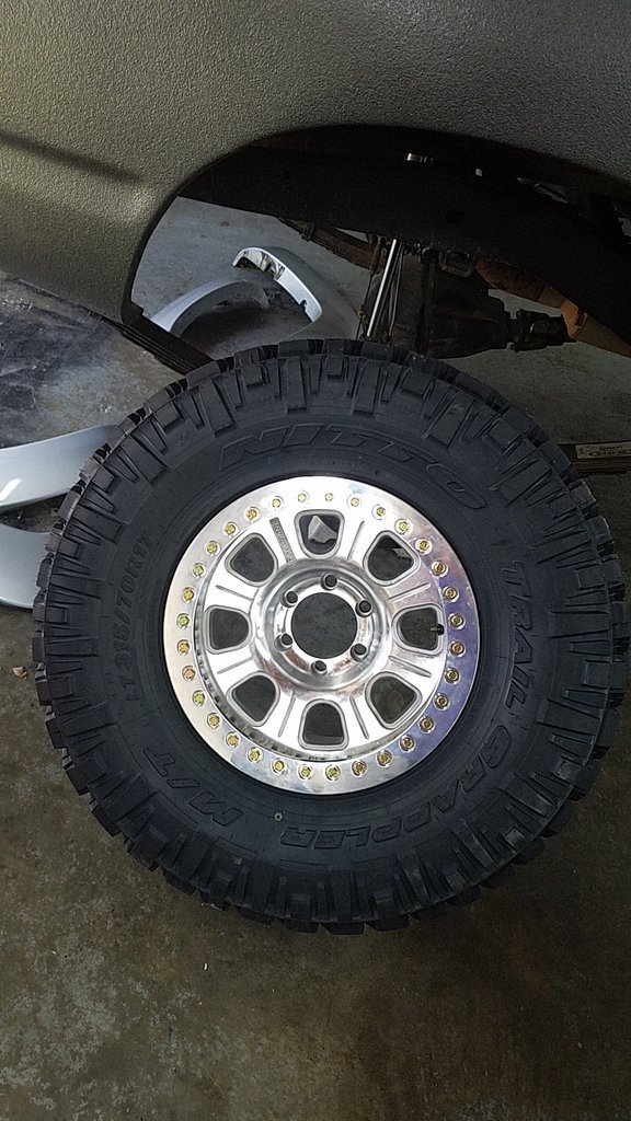

    New look for the truck 17 inch raceline monster beadlocks with nitto 315/70/17

    nfs257
    nfs257 Well-Known Member
    Jun 22, 2011
    #58691
    7,530
    DFW
    She gone
    is that bed liner for the paint? if so how do you like it...? I want to do that to mine but have been told the weight is a huge factor.
  18. Aug 15, 2017 at 8:39 PM
    #318
    Long_Travel_2002
    Feb 22, 2016
    #179105
    572
    ivan
    memphis
    Yes its lineX. Best thing i ever did. Holds up to absolutely everything ive ever throw at it. Only added like 80 lbs
    nfs257[QUOTED] likes this.
  19. Aug 15, 2017 at 8:53 PM
