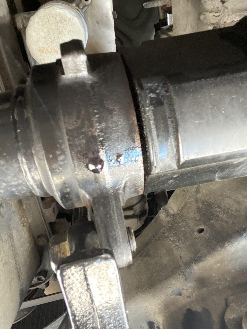

    Just bought my 98 tacoma 4x4 DLX and when I went to take the skid plate off to get powder coated, I noticed some red oil residue. At first I assumed it was my steering rack but when I looked closer, it looks to be coming from the passenger side front axle. Any ideas what this leak is and if it is an at home job?

    CV axle seal if anything is leaking from there, but it wouldn't be red.
    Red would depict coolant (factory stuff), power steering fluid (transmission fluid basically).

    Could have multiple fluids leaking.
    But a build-up of fluid right there is a cv axle seal; part numbers in my signature.
    Since you'll be adding new fluid, just drain the old stuff and put completely new stuff in it; 75W-90.
    Replace the plugs too; part numbers in my signature.
    When you remove the fill plug, make sure to use a pick to clean any and all dirt and grime out as the plug is pretty shallow. When you put your allen socket in, hit the rear of it with a hammer a few times to "break" it loose before removing it.

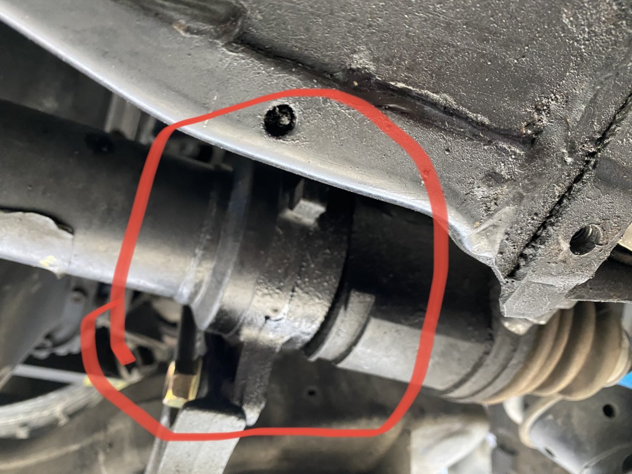

    Before you go all in on this being the axle seal- I'd get in there with some foaming engine degreaser or simple green and spray everything in that area from the top down. Agitate everything you can touch with brush something like this:
    And then rinse it really well. Once it's all clean you have to watch from the top down if any leaks re appear.
    The issue with looking at leaks like this from the bottom is that they could originate from anywhere above. You need to identify the source before you throw parts at it. And given that the fluid color doesn't match the gear oil you'd expect to see from the diff, it's unlikely to be the source.

    Update: so the leak is still there after degreasing and pressure washing the undercarriage and engine bay. Most of the fluid is on the bottom of where the CV axle goes into the carrier housing, probably due to gravity, but nothing in the engine bay is leaking, so i think its safe to say its coming from the carrier housing.

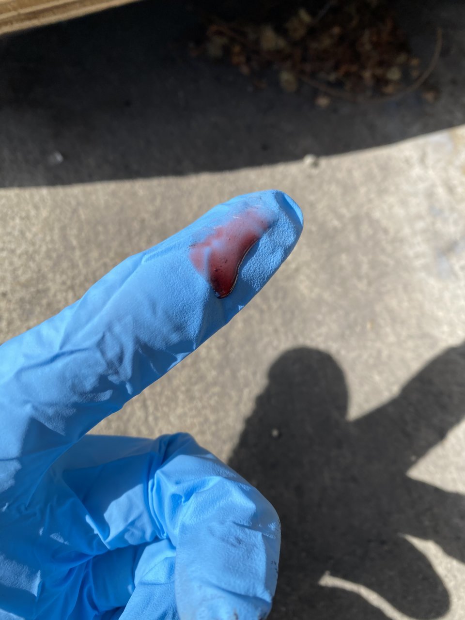

    The fluid is red, and smells like gear oil (sulfur). Never seen red gear oil before, but I am not really an expert in gear oil colors. I do think the output shaft seal is my culprit but please correct me if you think I am off base.

    May as well open up the filler on the front diff and stick your finger in there. If it’s red fluid, then you’ve found your leak.

    Yepp, its the fluid from the diff... thanks for the blatantly obvious advice lol :cheers:

    I started off initially saying you should change your diff fluid asap- and I don't think that's wrong. BUT... I did a due diligence google, and apparently there is one company that actually dies their gear oil red. Otherwise, if it's red in color, then it's almost certainly transmission or power steering fluid.
    If you, yourself, did not put red gear oil in there, I would err on the side of the unknown, and replace that immediately with gear oil (twice- once to get the potential ATF out, and another (100 miles later) to make sure . Those seals don't tend to fail easily, and maybe ATF would explain why you're seeing a leak here.
    I'd suggest at least a drain and fill on the diff, and see if the color of the leak changes. If it follows the color of the new gear oil you put in, you're 100% confident that it's an axle seal. If it's still red... then you're looking at PS or ATF.
