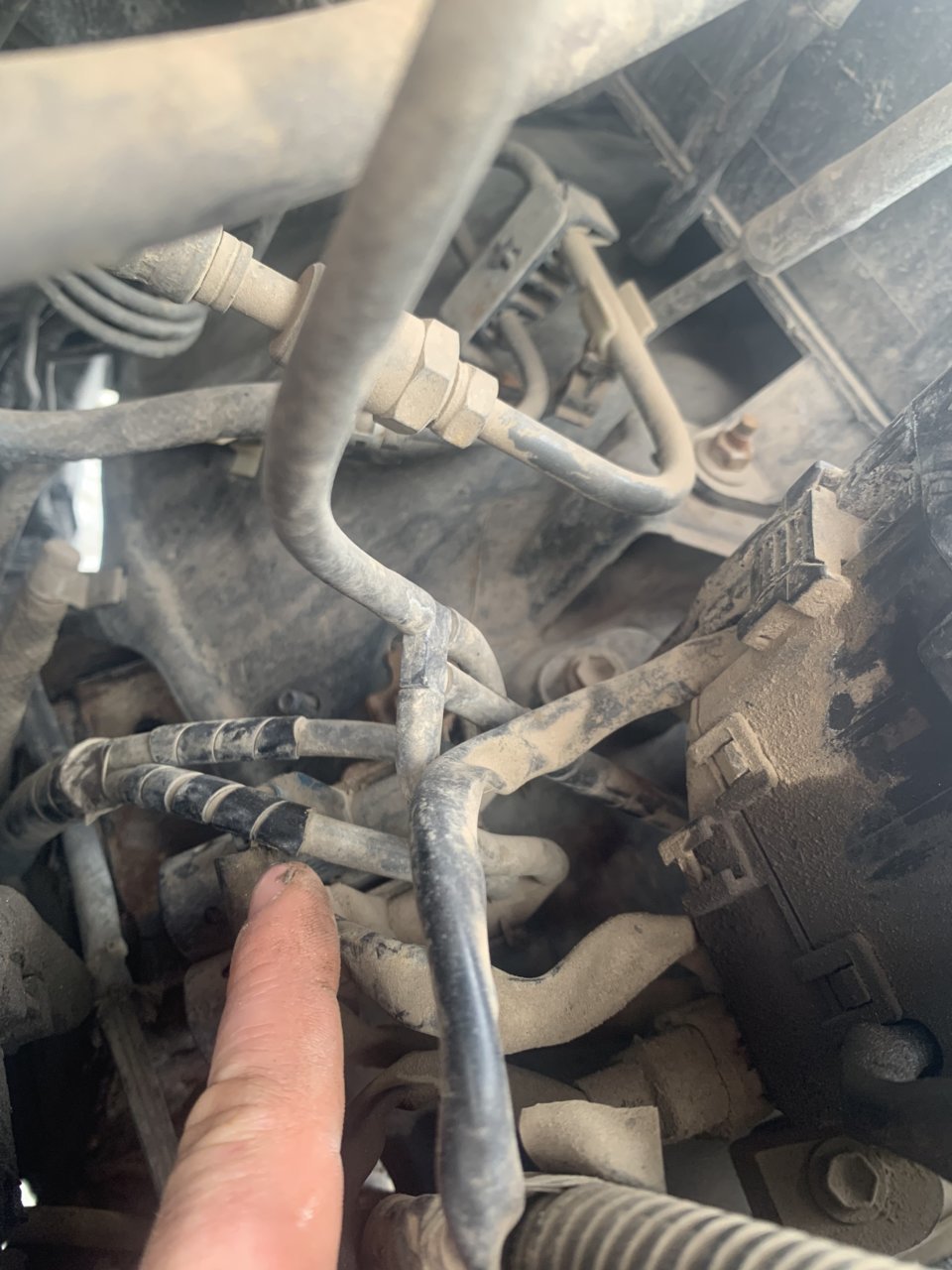

    Do you have a vacuum hose going to the actuator? I attached a picture blow air into the one vacuum hose and should work some time they get plugged up happened to mine has worked ever since. The one I’m pointing to in picture is the line you need to blow in if that don’t work blow in the other one

    Try that before ordering any parts it a free fix air costs $0

    I have the j shifter no button but I’m pretty sure there should still be a vacuum hose to actuator

    "Look"? Did you disconnect and clean them with electronic contact cleaner? It's a simple thing to do. The connectors can get dirt and water in them over time and sometimes just need to be cleaned.
    The electronically activated 01+ (even j-shift) don't have vacuum lines to the front diff actuator. There are breather lines though. Easy to get confused.

    That’s 100% vacuum lines and they go into a solenoid

    Or if they aren’t what ever the hell they are lol it worked to engage 4x4

    OP has an 01, so suggesting he try clearing the vacuum lines is unlikely to work for him, as he'll be "clearing" a breather line.

    never know till you try it take 2 mins and is free . Worth a shot
