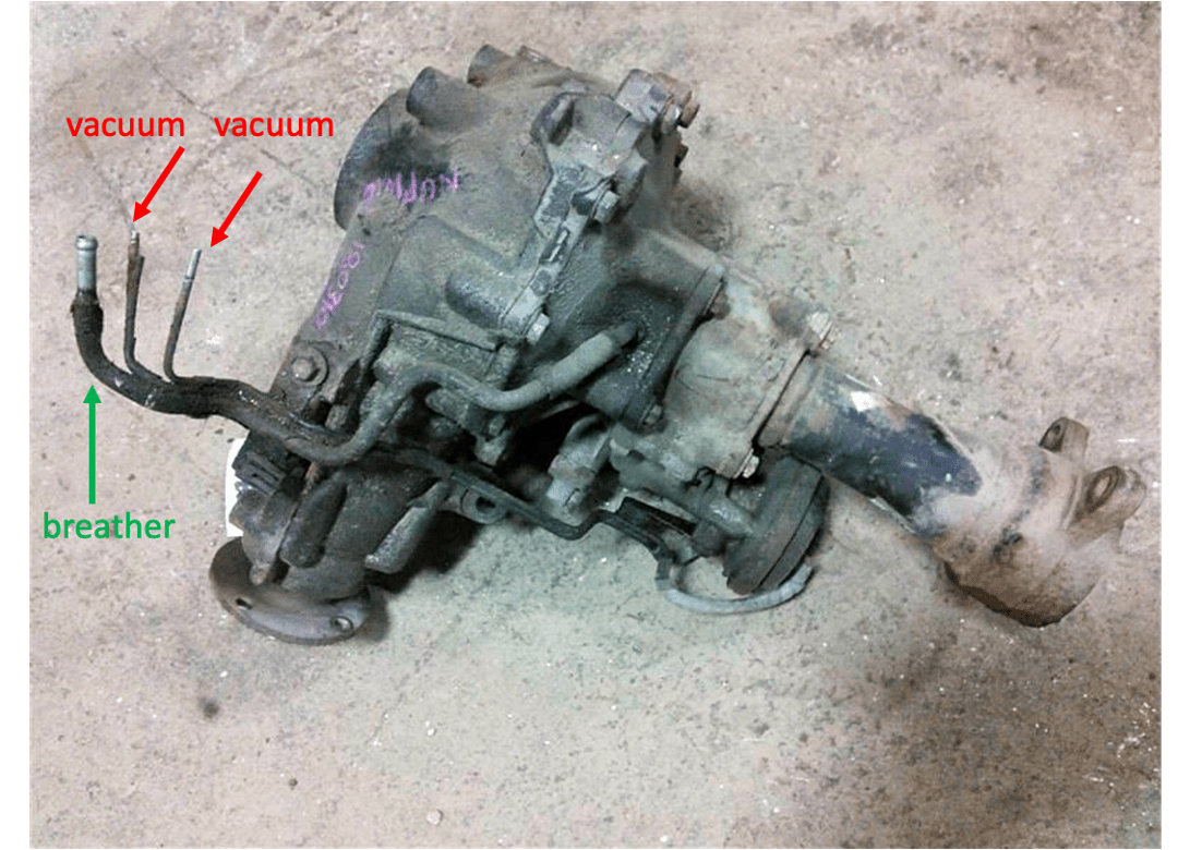

    Sorry for reviving this thread… but I exhausted all my options and I’ll admit- I NEED HELP.
    2004 tacoma 4wd, crawl box, everything done to it.
    4wd hasn’t worked for a while. I have it up on stands right now. 4wd light on dash is blinking. I took actuator off of transfer case. Reset it, put it back in, and light was off. Then pushed 4wd button, I can hear it engage. Still blinking. I have the ADD actuator off now, and tested it with a spare battery and it moves the fork left and right just fine. When I go to plug it back in, it does nothing. When I try to Unclick the 4wd button it does nothing. I can only manually disengage it.
    On the 1st gens I saw that the tube on the actuators is not a vacuum line. Is that correct?

    The autimatic disconnecting differential (ADD) front differential is a vacuum actuated - manual hub trucks don't have any vacuum system, but were not a factory option after 2000. There's a little canister (reservoir) in the driver's wheel well. It only serves so that you can engage / disconnect the front differential if the engine is off and not making vacuum. It can be bypassed for trouble shooting if you are doing your testing with the engine on.

    Vacuum ADD started to be fazed out in 95 iirc. After 99 they were all electric. The hose on a 04 actuator is a breather. It terminates in the engine bay at the drivers side wheelwell.
    I recommended to test the sensors on the transfer case and ohm out the harnesses. Their locations & wire colors are all listed in the ewd section of the fsm downloadable from this site.
    It involves ripping out the dash. If that's scary for you, just swap out the actuators for new ones. Because they're the most likely problem causing issues with your 4×4 circuit.
