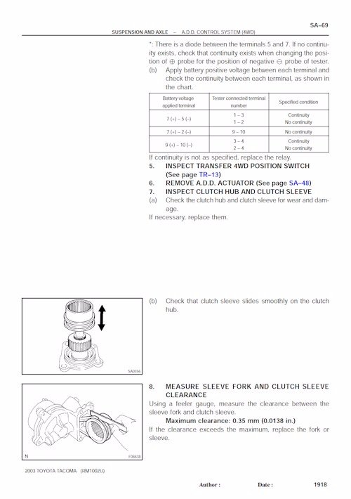

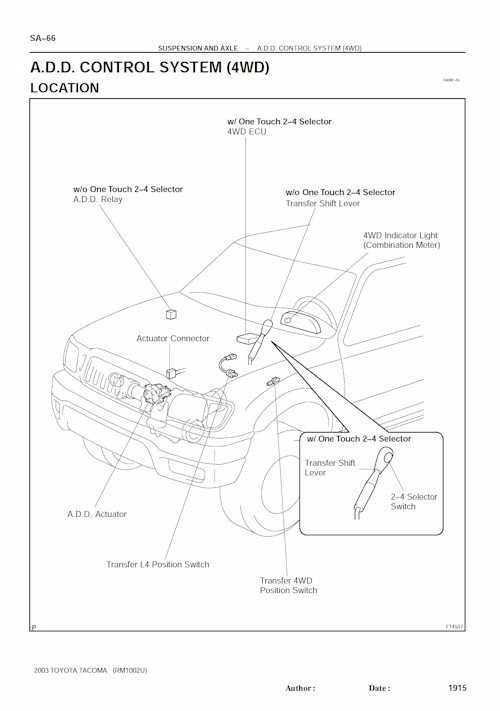

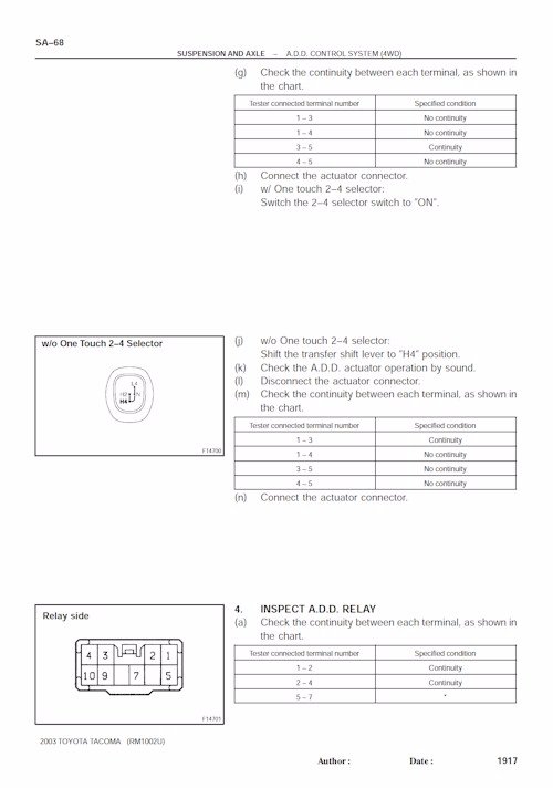

    Here are pages from the factory 2003 shop manual FWIW

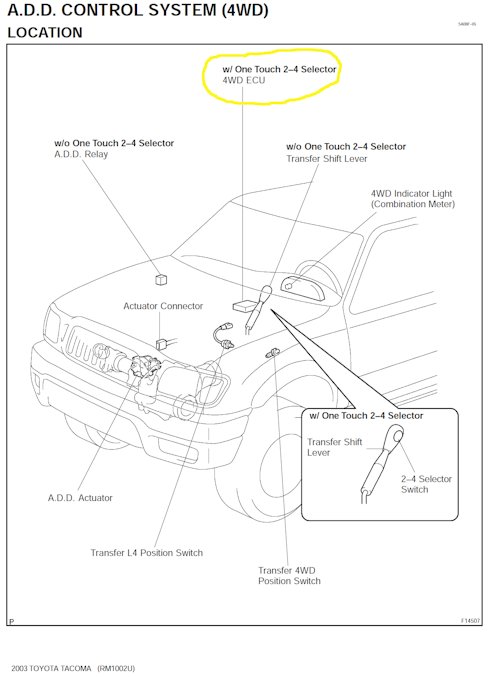

    if you are referring to the "4WD ECU" its shown here in the 2003 Manual, which in the 2003 V6 was behind the center console.

    It is either behind the center console/ash tray or behind the glove box.
    As the glove box may be easier to remove I would check that first just in case

    All years, it's between the stereo and SRS computer.

    Looked under there tonight, found a green box and I think the other was silver. Didn’t get a chance to try to get either out.

    Yessir. Green box. That's the 4wd ecu.
