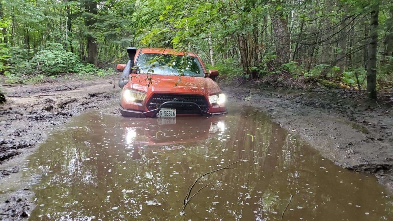

    I’ve been through a few pretty deep water crossing this year. F662B976-16CC-4CC9-888B-DBF9D1E1C9D0.jpg
    Lt. Dangle, =JSG=, DAS Taco and 3 others like this.
  10. Sep 21, 2020 at 4:32 PM
    OnHartung'sRoad
    OnHartung'sRoad -So glad I didn't take the other...
    Jul 24, 2017
    #224878
    9,398
    Somewhere in the Mojave Desert...
    2017 Tacoma OR 4x4 (formerly 2002 OR 4x4, 1995 4x4 4Runner, 1985 4x4 Toy PU) ... and RIP’s (rust in pieces) to a Bronco II 4x4 & S10 Blazer 4x4
    Pull the actuator and open it up, that’s probably your issue. I wish someone made a waterproof one, I have avoided doing some deep water crossings for this reason- because of the problems people had with theirs. I think water clarity probably plays a big part of it, if it’s a fresh water crossing it probably not as bad as a salty or silty water. We have pretty salty water out here in the desert whenever there is a crossing, and I go around.
