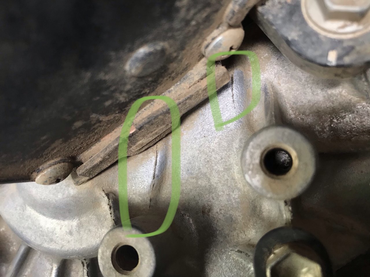

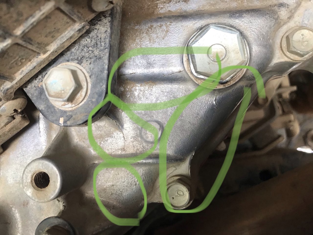

    I should also mention I took a look further at my transfer case today and I see almost like stress fractures on the transfer case itself. Not sure if this in normal but does not look normal. Here are few pics of what I mean. No oils leaking out but looks like little cracks in multiple locations on transfercase.1733A5FC-AFD1-4588-BA9F-241A93B6C24F.jpg

    I think those are normal. Flashing from the molding process? Again I'm just an idiot lol

    Seen them many times on many vehicles, including this one.

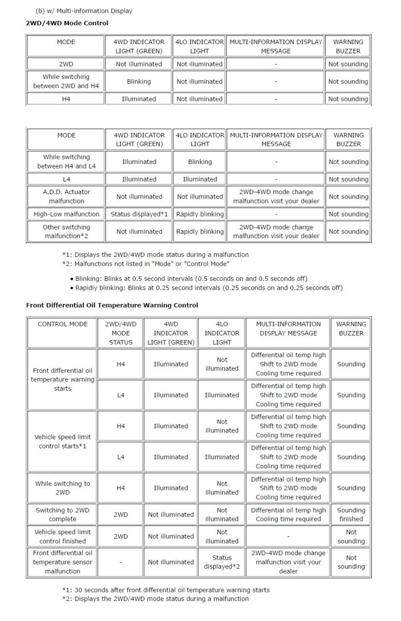

    Is it an amber or green light?
    Is the interval .25 second on/off or .5 second on/off?

    It’s is a green light and will go out and check intervals now

    It’s about 1/2sec maybe bit longer but definitely not .25 of a second

    A.D.D. malfunction should be a blinking (.25 second on/off) amber light or a message in the multi-display.

    Yea I get nothing on display when turning 4wd dial No click or anything only green blinking 4wd light even in 2 wheel. No 4 low light blinking either just 4wd light. Any ideas probably transfercase actuator do you think or something else?

    I missed the fact you have an Offroad. Should be a multi-display messsage for ADD malfunction.
