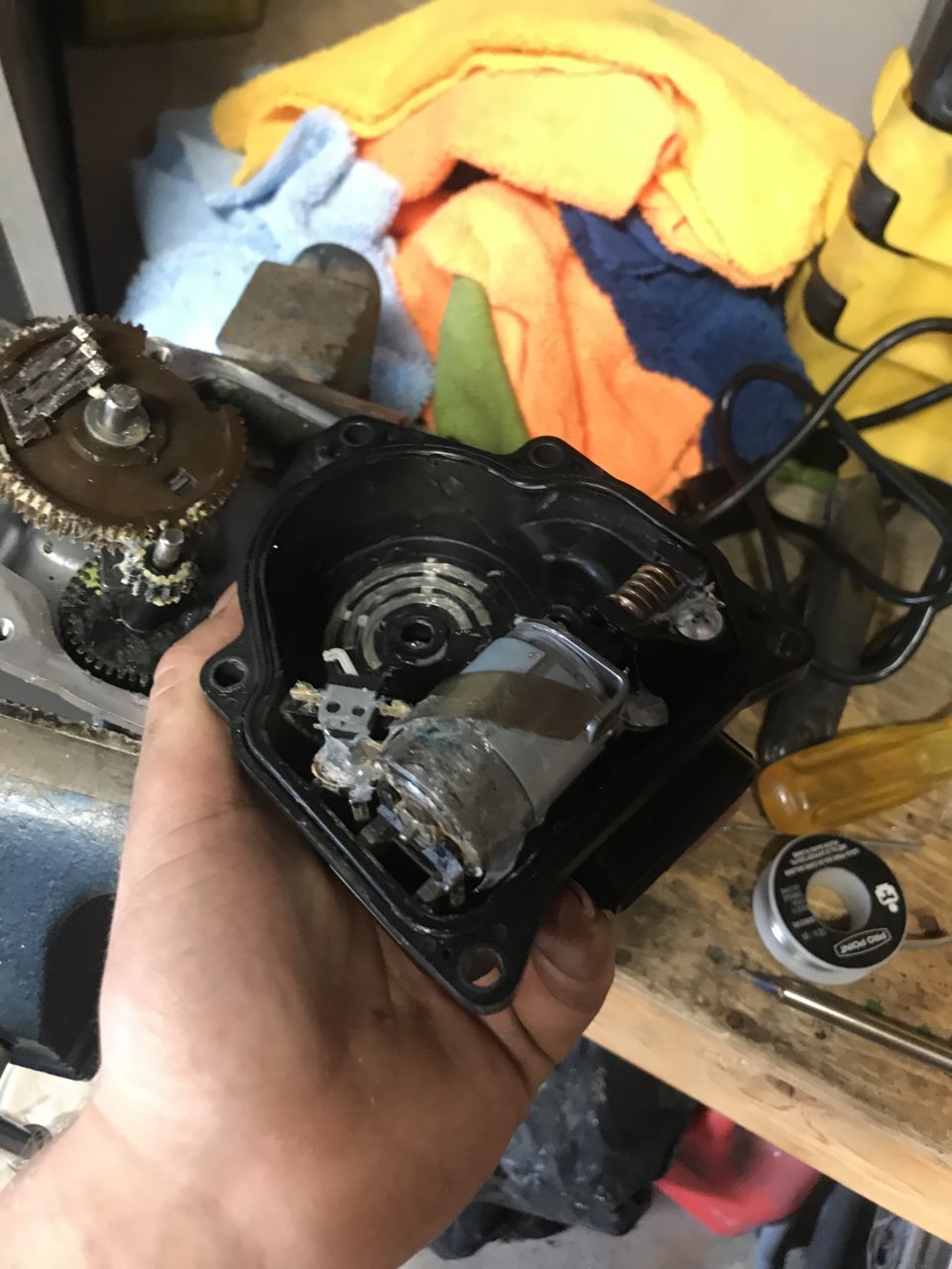

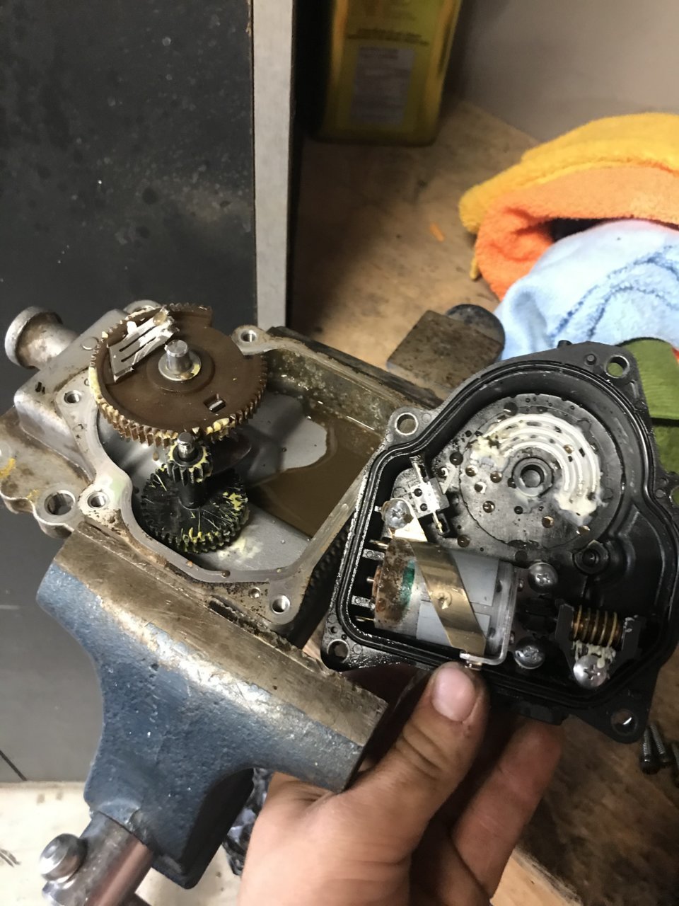

    So I believe I’ve fixed the problem now but won’t know 100% until tomorrow as ive got to wait 24hrs for the gasket maker to fully cure before putting oil back in the front diff. I ended up pulling my front a.d.d actuator and found water inside with a bit of corrosion. I sanded down the corrosion, soldered the motor leads and put dielectric grease on everything. When I turned truck on, my 4wd light is not flashing anymore. Also tested motor when it was out and it was working.37660E29-89A7-42C4-AFEC-99AD7E54D36D.jpg

    Any indication of where the water got in? (To hopefully seal it in the future)

    Glad to hear it appears fixed, and appreciate the update.
    One note: The feedback wipers give a non acceptable reading to the ECU when the ADD motor is operated too far either direction. While reassembling the actuator it is possible to end up with the actuator in this condition. In that case, there is nothing necessarily wrong with the actuator, it just needs to be manually (physically or electrically) operated back to a mid position where the feedback is acceptable. This should only come up while reinstalling or replacing the actuator, not in normal usage. If you appear to have no lights with ignition ON, then you should be fine in this regard.
