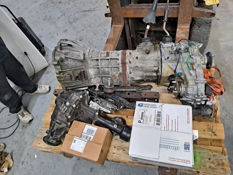

    Ok, I'm waiting on the bigger parts to show up. At the shop right now are the FJ inner and outer shift boots, FJ transfer case from an automatic with a manual shifter, transfer case shifter arm (No shift knob though.) Front driveshaft, rear driveshaft, 4x4 front hub assemblies, Front CV shafts, Manual 4x4 transmission cross member, front differential bushing that replaces the roller bearing and hub seals.
    The R155F trans and the Tacoma 4:10 front differential are in route to the shop.
    Once I have all of the big stuff sitting in front of me, I will make a list of mounts, hardware, bushings and parts that I will replace while in there. I will order those and then get this party started. I expect to do most of it in a Saturday or two. I'm doing this to my daily driver, so I have to do it and keep my truck on the road at the same time. Well, that's unless I fire up the old 240sx and drive her to and from work for a couple of days...20150411_164804.jpg

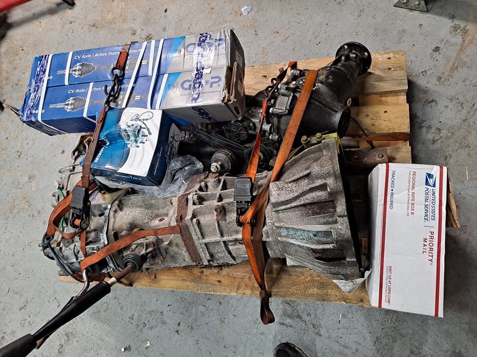

    Well, I was getting closer then hurricane IDA came through and gave us a rough ride. The project is on hold for the moment, all parts are palleted and on a shelf in our shop. I'm waiting on all delivery services to come back online in and around my area so that I can order around $200 worth of small parts. After that, I should be good to go. The cheaper hubs and axles are just to get the ball rolling. I will be sourcing Toyota components after I have it all together. With the recent storm, I just might find complete trucks in the yards close to me.
