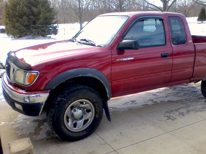

    It's Impulse Red Pearl. I've got the 02 with sr5 package. What the hell, why not give ya a pic just for funzies!
