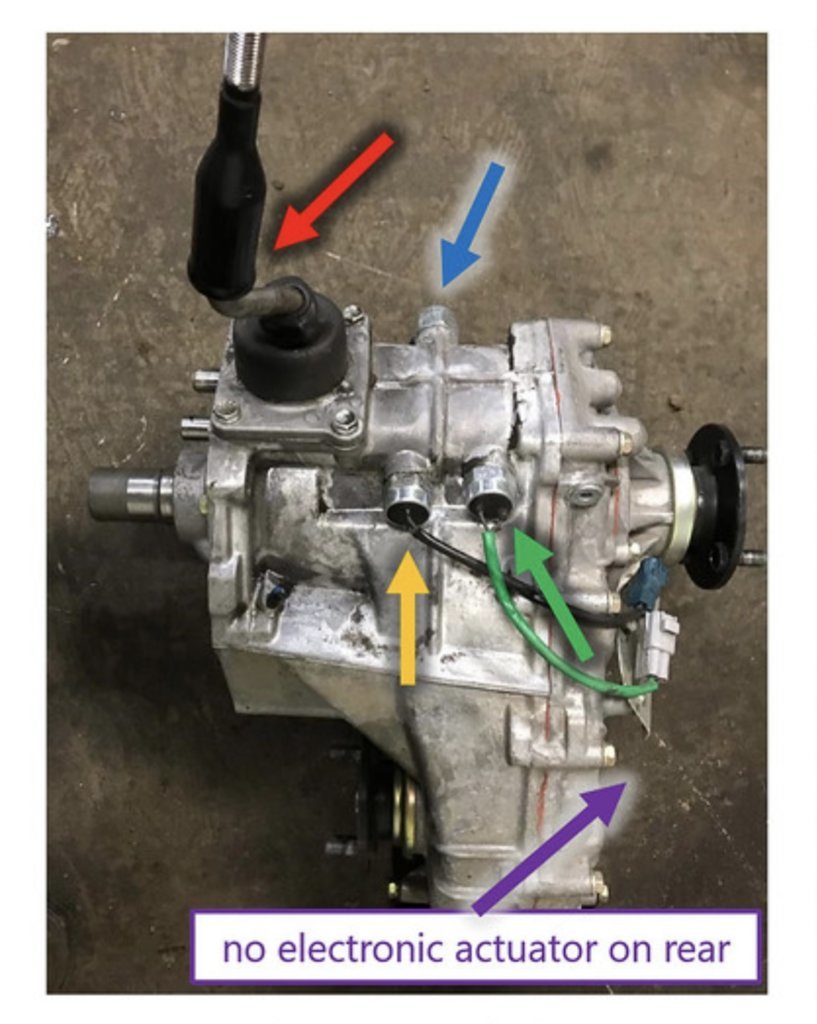

    There is a good reference at https://www.tacomaworld.com/threads/1st-gen-transfer-case-identifcation-for-replacement-swap.753707/ put together by @turbodb that shows the various configurations and switch locations, etc. I’m guessing your transfer case is a j-shift? You’re looking for the switch near the top of the case indicated by the blue arrow below:
    It’s pretty easy to get to and replace. That sounds like the most reasonable cause of the issue you’re describing.
