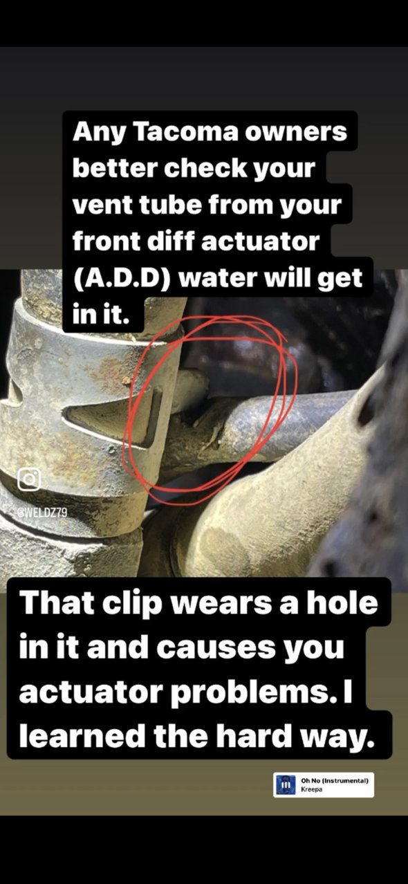

    I had the same issue. My front ADD was full of water. Ended up finding a hole worn in vent tube. There’s a clip that hold another line on and every Tacoma I have looked at all are rotated back and they rub a hole in the vent tube so I would double check that. E7DC9DE6-70FC-4863-B952-4E9CE53B2B3D.jpg
    Dm93[OP] likes this.

    Thanks for posting that, what is the location of that clamp?

    If you follow the small short rubber vent hose off the ADD to where it goes into the hard line, then there’s a short hard line and then it goes back to rubber after the short hard line. Follow that 2nd hose that goes up to the top of the engine bay. It’s not too far up from where it comes out of the hard line. Some Tacomas have about 1/2” clearance and some are rubbing. I have a 2012 and I’ve looked at em all the way up to a 21 and that clip is in the same orientation. You can try rotating the clip or just bend the hard vent line back a bit to clear.

    Interesting, I'll have to take a look at mine.
    B.Root[QUOTED] likes this.

    I would if I were you. My ADD was acting up so I pulled it and soldered the connections and cleaned it up an siliconed it all back because there was a little water in it. Reinstalled and was working fine for about a month then pulled it again and it was full of water. I started trying to figure out where the water got in and found that hole. I took that pic and posted it on my instagram account. Ended up having to buy a new ADD and replaced the vent tube and extended it up by my brake booster.

    I check my hoses everytime I have it on the rack to change oil or do other things but I didn't know about the clamp, if I can find it I'll get a better picture and post it at the top of the thread.

    ok I’ll look tomorrow and see what hose that clips on. You can’t miss it if you follow the vent tube. Maybe follow it down from top of the engine might be easier but you’ll see it.
