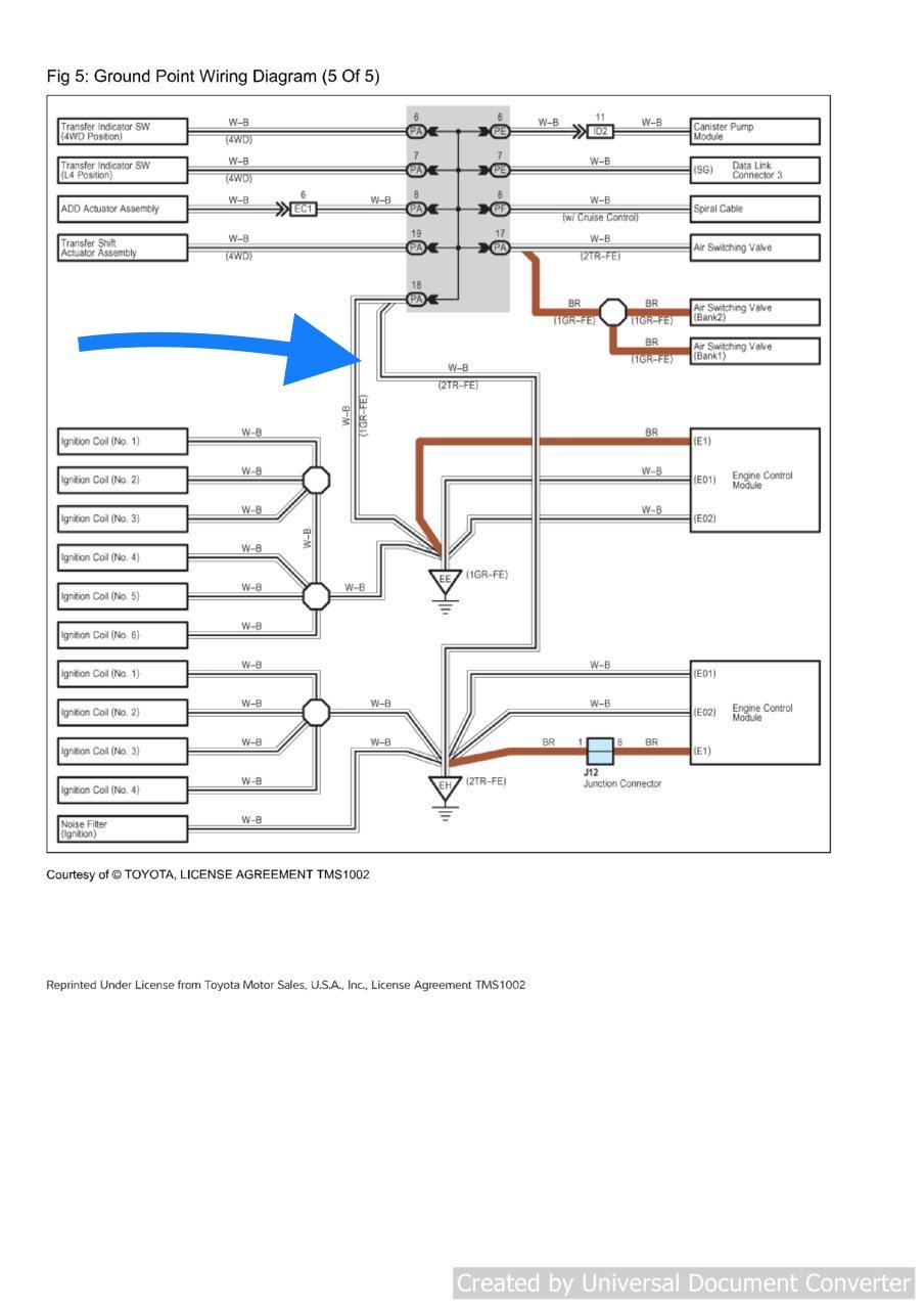

    Holy shit this diagram helped a ton. Thank you dude.
    So if you’re thinking 18 is the culprit, those two are the grounds in the engine bay correct?
    Since that ground is shared with the ECM’s in that diagram, wouldn’t I notice issues with them as well?

    Not if it is the just that one wire from PA18 to EE. 441676CA-B3CD-4B89-8EA3-02451347E7B6.jpg

    Ahhhhhh I’m trackin’ now. So if that is the problem, it’s chasing that wire to the grounding point in the engine bay and finding an issue somewhere between the two. I’d imagine it’s just a straight shot Through the passenger side firewall?

    If you are lazy (like me) you could just make your own ground. Splice a new ground wire into the wire coming out of PA18.
    I don’t know how the wires are routed.
    But you could look if you want to?
    Just not sure it’s worth MY time. :thumbsup:

    I would suspect it would be broken somewhere near where it attaches to the cylinder head but it could be anywhere in the harness from EE to PA Pin 18.
    Trace the harness out and look for damaged areas and where it could be rubbing on something and give the grounds a tug to make sure they aren't broken internally.

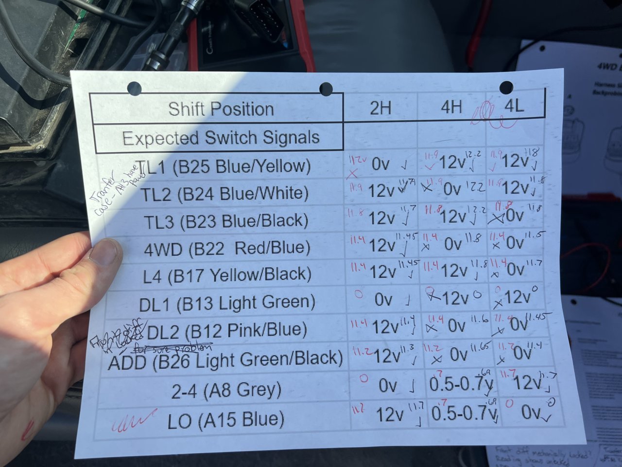

    ***Update***
    Okay boys so just did a sanity check from the beginning by checking mechanicals first.
    I shit you not. This thing is no longer in 4wd. The wheels do not spin opposite and the driveshaft can be spun by hand. The only thing I can think of is that I checked both before pulling completely off the driveway to do the checks going in forward/reverse and it unlocked itself?
    So, with all of that. Truck is now mechanically in 2H which the position switches show.
    Now. Where from here?
    Just put Cab switch to 2H. Then put negative terminal back on battery. Put key in and lights still flashing. Gonna recheck all voltages to sanity check and will report back.

    Updated voltages.
    I never said I was a smart man.
    TL1 12v in 2H. The rest remained the same. Red pen is today’s readings.
    So given this. Sounds like the TC actuator is the issue and is out of sync? Front diff is reading correctly since now I see mechanically everything is 2H, but won’t lock due to the TC being the issue correct? DFC0DF5A-1551-4B3B-88DA-CEE6AB5AC5AE.jpg
    Edit* - idea here. Couldn’t I use a AA or 9V on the leads at the actuator to reverse polarity the motor back till it reads 0v at TL1. But since I’ll have to unplug the harness to get to it all. I’d have to get readings from the TC actuator itself.
    Does that sound right or am I just trying to avoid taking the thing off? Lol

    None of your TL wires are being pulled to ground.
    Have you made sure the ground wire is good?
    That would be pin #10 of the PA connector.
    That’s why Dm93 asked you to check those earlier.:thumbsup:
    You could also unplug the TC actuator and check the the white/black wire for a ground. But you already know the inside of the truck. So might as well start there.

    I was ass backwards. I thought because I’ve got 12v across TL1-3 that meant it was stuck between 2H and 4H.
    Okay more numbers for ya.
    PA 6,7,8,18,19 all 0v
    PA 10 is 11.4v
    Ground Wire is 0v at the T4 connector.
